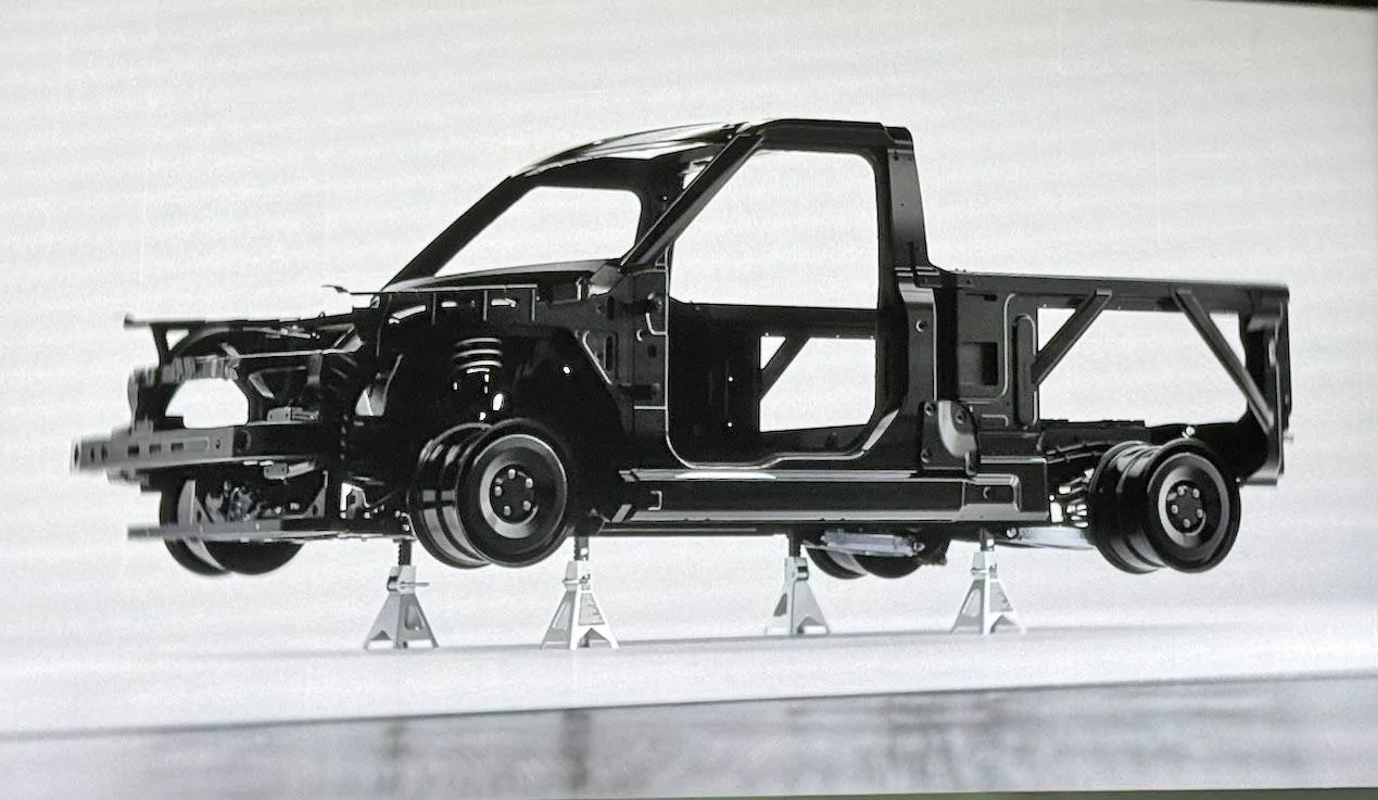

I don’t think it’s ever smart to talk about future models, especially before releasing the current one. Slate is going to Osborne itself somewhat due to this.
603
968
When this interview came out a while ago, I didn't know what he mumbled.
Now that I know, I realized I'm not exactly sure what this means.
What does "package protect " really mean?
I believe it means that the current design can be altered with little modifications to the rest of the design.
An example would be adding 12in into the middle without having to increase structure elsewhere.
Or being able to add a front motor without having to design a new front suspension.
603
968
I think if the 2 door doesn't fill capacity they will probably pivot quickly to the four door. As long as they have some sales they should have enough cash flow to make the modifications and they could even be built on the same line, other manufacturers do similar things.
19SL80s
Doug
Jul 23, 2026
77
136
Columbus, Ohio
That’s good if they can pivot quickly. I guess they can’t put four doors on the current model due to the wheelbase?
Figuring out where to put all the components of all the vehicle systems is "packaging". Package protect means defining "keep-out" areas where none of those components may be located. In this case, those keep-outs are the areas of the chassis that would have to be removed to create two more door openings. Basically, it means you could design a 4-door body that would take all the same non-body parts in the same locations.

i seem to recall Eric Keipper using that same "package protect" phrase when talking about the frunk space in one of the recent price reveal event videos.
He did. I remember as well. I took his statement to mean the body in white was designed from the get go to be a 4-door with respect to passenger crash protection.

I don't think they can just slap 2 more doors into it without a different frame.
Ah, yeah. I see what you mean. The bed of the truck interferes with that.

Wait, the chassis was designed to allow a four-door variant, like sticking an extra slice of cab in the middle?
Dammit. I need to check this and change some notes.
352
761
What they're saying, as I understand, is that they can expand that frame without fully redesigning it, and while hopefully reusing most of the parts.
