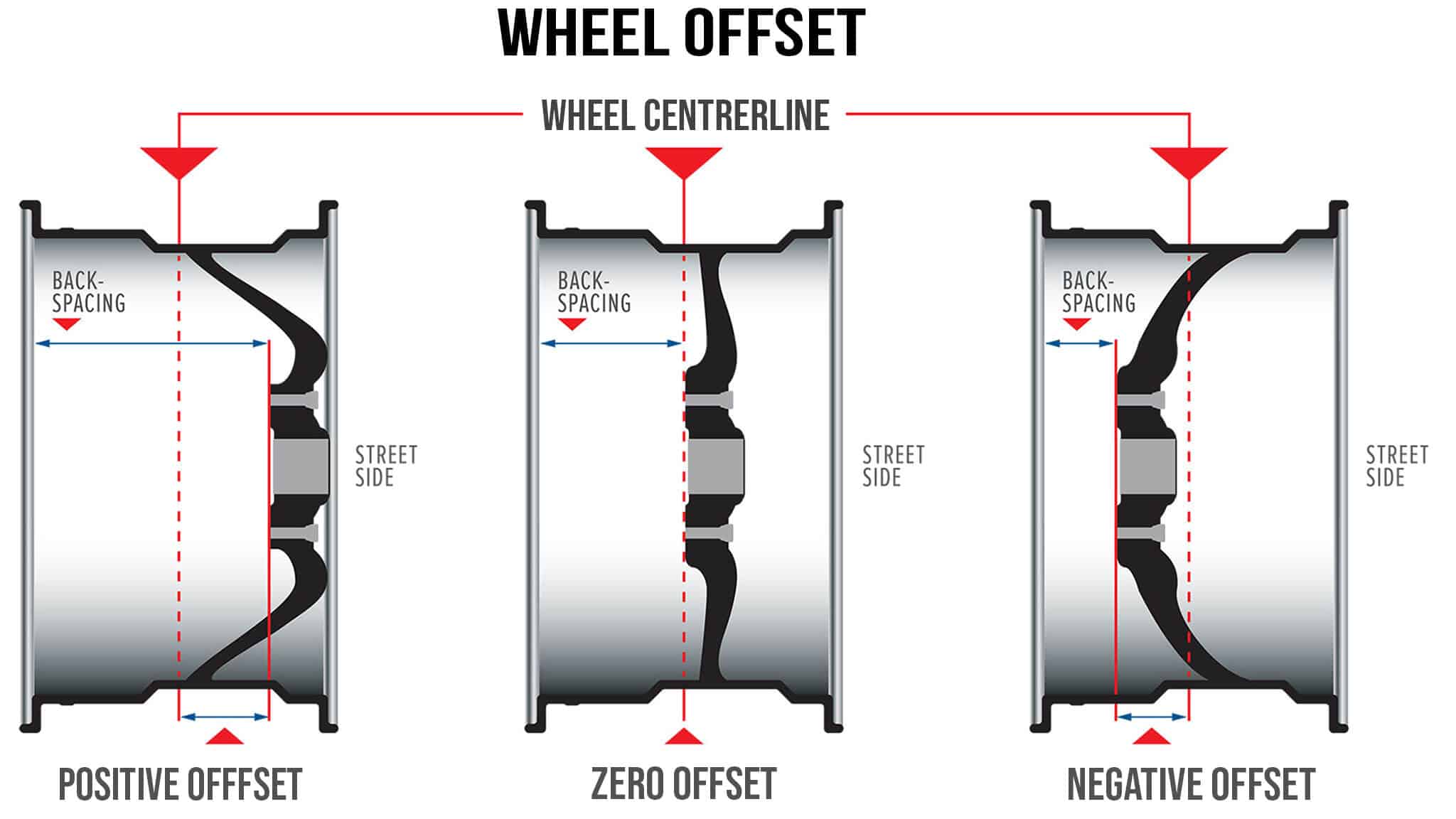

Installing a spacer does the opposite to what is intuitive. Taking a +25mm offset wheel with the addition of a 30mm spacer does NOT equal +55mm offset, it would actually be equal to -5mm offset.
Yup! If you want a wide stance, just get "normal" low-offset rims (and fender flares, to limit poke)! You don't need spacers. This is the driver tire, seen from the front:
Slate Auto Pickup Truck Aftermarket wheels - has anyone chosen a manufacturer and/or style? wheel-offset-positive-zero-negative
It will, of course, mess with your scrub radius and steering feel, increasing wear on wheel bearings/tie rods/ball joints. But it's not much worse than a lift kit and off-road tires.

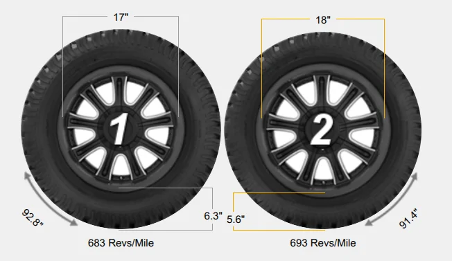

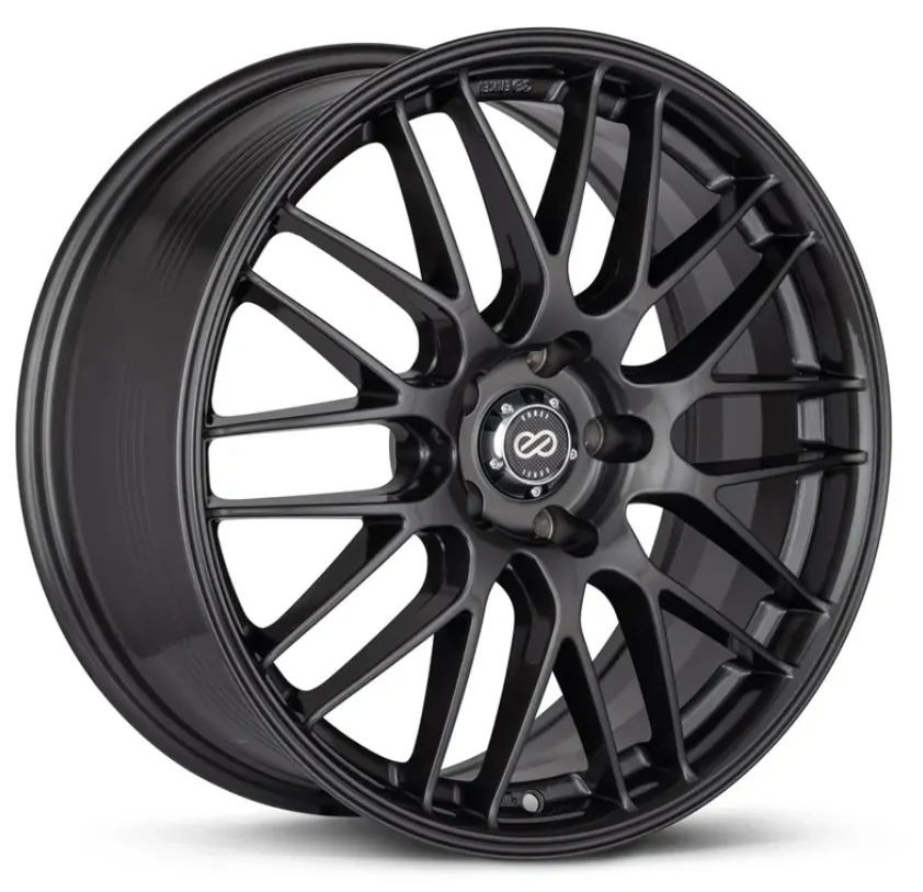

My current top choice is this 18x8 Enkei EKM3 in gunmetal (dark gray) color. I chose it more for weight, quality, and price than for appearance. IMHO Enkei is a good manufacturer.
Slate Auto Pickup Truck Aftermarket wheels - has anyone chosen a manufacturer and/or style? Enkei_EKM3_Wheel
It has 42mm offset.

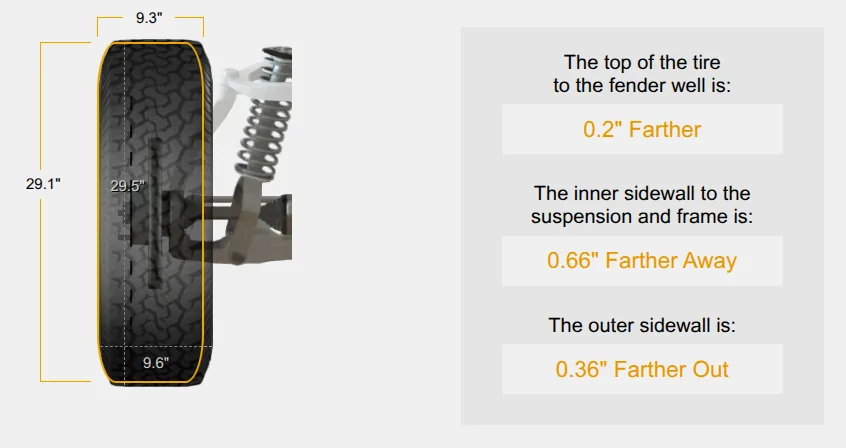

Here it's shown with 235/60R18 tires, which have only 1.4% less circumference (10 fewer revs in a mile) compared to the stock 17" tire:
Slate Auto Pickup Truck Aftermarket wheels - has anyone chosen a manufacturer and/or style? 235-60-18_42mm_Offset
Slate Auto Pickup Truck Aftermarket wheels - has anyone chosen a manufacturer and/or style? 235-60-18_Revs

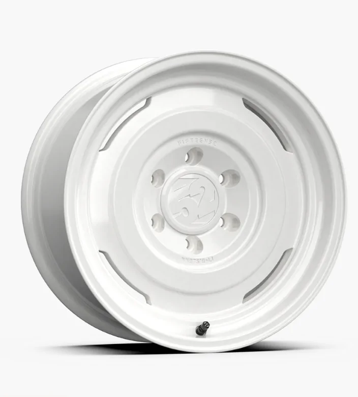

I'm searching for white, spoker wheels similar to those on my 1984 mazda SE-5. I also want aluminum to reduce weight. These Fifteen 52s were on a prototype in Fort Worth and although not a spoker, it looks really nice
That design is a "yes" from me, but I want it in grey.
