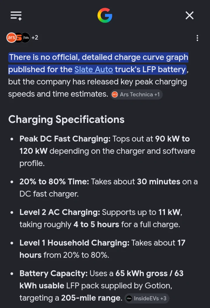

Looking up skates lfp pack and not much info on that.
Slate Auto Pickup Truck Charge Curves, batteries and South Dakota dreaming. Screenshot_20260803-081904

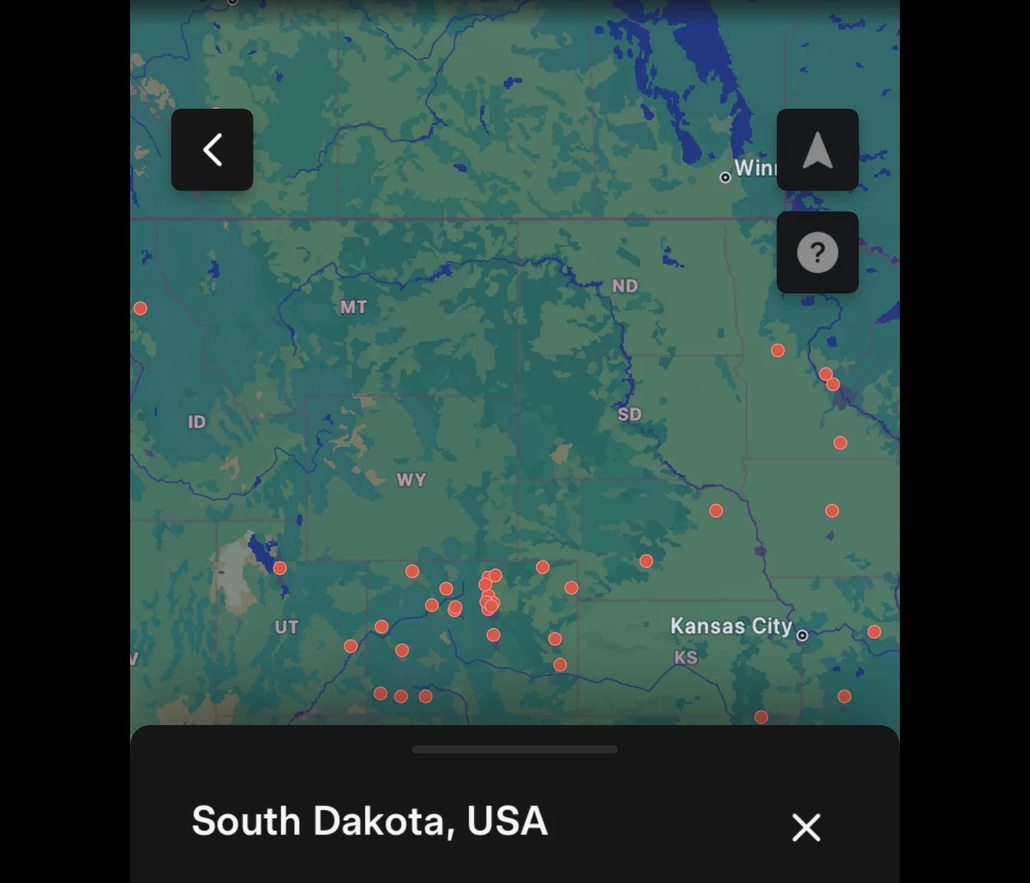

From the Tesla app configured for a non-Tesla with adapter. It isn’t just SD.

You don’t understand the Slate NACS port is no different than a CCS1 with NACS adapter. The issue is that v2 Superchargers don’t use the CCS protocol that NACS uses. They only use the proprietary protocol only Teslas use. They look the same as a CCS compatible v3 but the cable is thicker and has a silver metal ring between the plug and the cable. The Tesla app won’t show them as available to you. Only Teslas have full access to the whole Supercharger network.

Ah, gotcha. I wasn't aware of that.

Yep. If you’re staring at a row of Superchargers you don’t see in the Tesla app, that’s why.
Since I'm driving a Model 3 now I never thought about it.

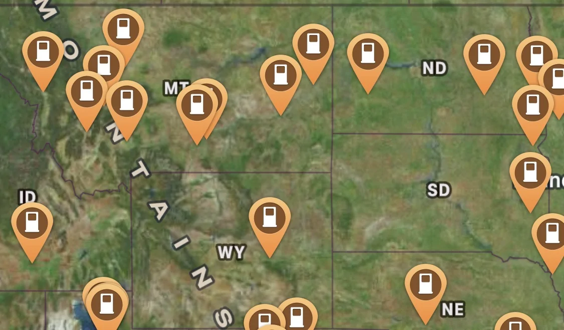

Slate Auto Pickup Truck Charge Curves, batteries and South Dakota dreaming. IMG_2621
It doesn’t look as barren on Plugshare’s map, but it still ain’t great. Especially Wyoming 😬
I did NACS-only and filtered out old V1 stations that don’t work with non-Teslas.
Edit: There’s also one in Rapid City, Gillette, Buffalo and a couple other spots that don’t show up til you zoom in.
