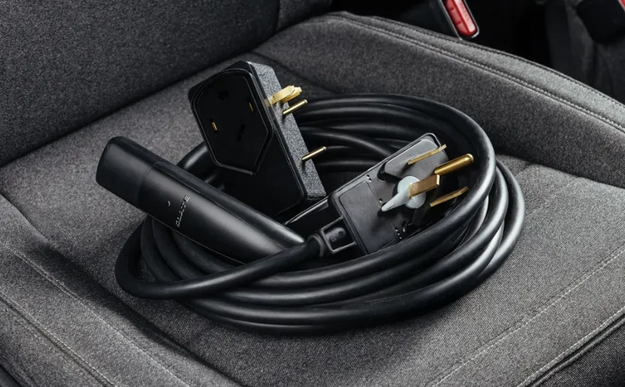

From the FAQ:
"The included Standard Charging Cable works with NEMA 14-30, 14-50 and 14-60 outlets."
007
253
283
Mazda
From the FAQ:
It looks like there's an adapter included that will allow it to charge in a "normal" 120v outlet.

From the FAQ:
Yes, so by default must support 240V @ 24A and 40A. The 14-60 outlet is uncommon, but not clear if they support 48A charging through this EVSE, or still just 40A, but physically plugged into a 14-60 if that is what you happened to have.
To do 240V 16A charging it would need an adapter to a 6-20 plug, or the ability to use a generic adapter and set the current limit with a switch (not likely).
beatle
