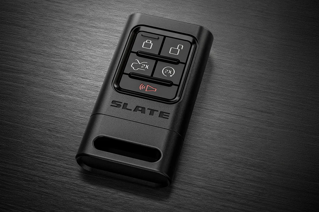

What is the 2x button on the lower right of key fob? For some reason I thought that would remote “start”, or precondition, the system.

I don’t know. I thought roll down the windows, but that doesn’t make sense with manual roll down windows. Preconditioning should be a lightning bolt icon, in my opinion.

Ah, I see. But how would it know what to set the climate at remotely without using the app on your phone? Maybe based on what it was on when you last left the vehicle?

The 2X button is "remote start" ... you hit the button 2x to turn on whatever cabin heating or cooling setting you have the controls at.
On ICE vehicles it turns on the engine and gets the same effect. On an EV it's just turning on the HVAC system.
