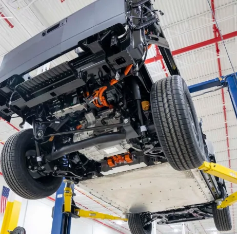

Here's a close-up of the standard rear drive unit on a lift, with the rear bumper removed. It appears that the HV wiring harness (orange cabling) is routed just below the top of the wheel well. I understand everything is sealed, but I would be extra cautious not to back down the ramp > 6" of water if using a standard 9-degree sloped boat ramp. A lift kit (with spacers) would be even better.
