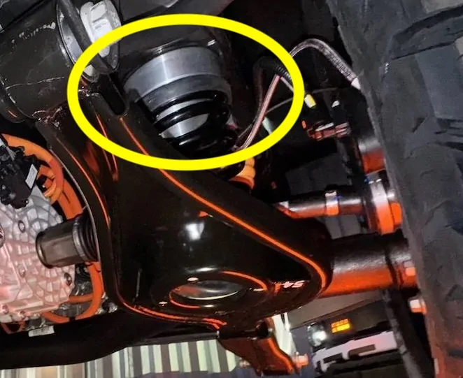

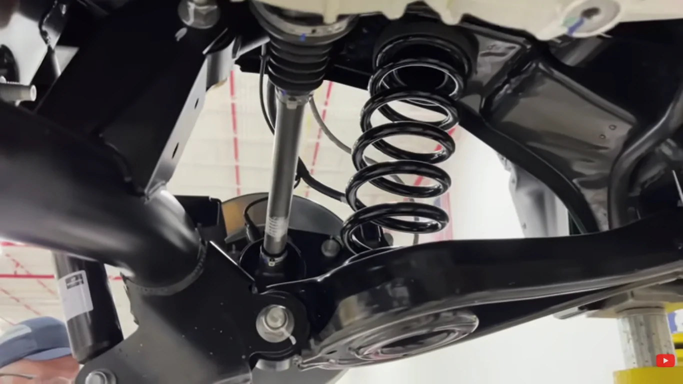

Blank Slate suspension:
Slate accessory lift kit:
Can anybody spot the difference? :idea:

Up to this day all any of us have seen are Slate prototypes. No one here knows what the final production suspension versions are going to be comprised of.
290
517
I literally know nothing about suspensions. Is this the 2" spacer everyone is talking about?
That's the one. Good eye. :like:
Yes, that is a spacer; whether it is a production spec part or just a machined part used for prototype development of the suspension lift, is the point of the discussion.
No one has indicated what Slate's approach is for the lowered suspension...
