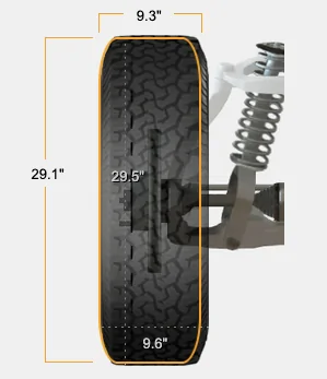

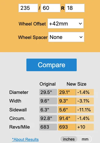

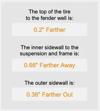

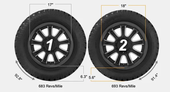

My current plan (subject to change without notice :) ) is some 18x8" wheels and some snappy run-flat tires. It looks like the size I found will fit perfectly.
Slate Auto Pickup Truck Factory OEM Wheels & Tires Specs, Offsets, Bolt Pattern, Hub Bore Size, Weights 18x8-42_Wheel_Fitment-1
Slate Auto Pickup Truck Factory OEM Wheels & Tires Specs, Offsets, Bolt Pattern, Hub Bore Size, Weights 18x8-42_Wheel_Fitment-2
Slate Auto Pickup Truck Factory OEM Wheels & Tires Specs, Offsets, Bolt Pattern, Hub Bore Size, Weights 18x8-42_Wheel_Fitment-3
Slate Auto Pickup Truck Factory OEM Wheels & Tires Specs, Offsets, Bolt Pattern, Hub Bore Size, Weights 18x8-42_Wheel_Fitment-4
