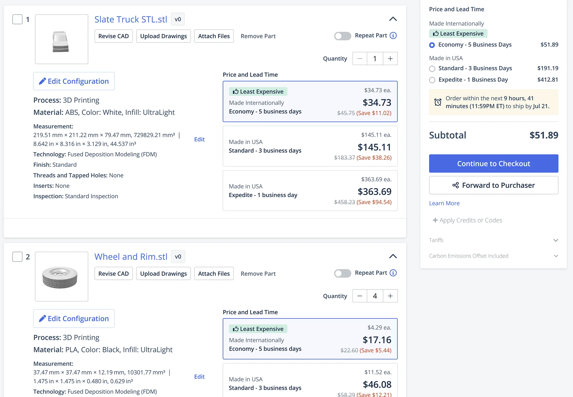

I think you want millimeters, Slate is 4434 mm long and this model is almost exactly 1/20th that scale in mm.
Form Now will get you an astonishingly high-quality resin print, Xometry can make you a basic FDM print (you're going to be post-processing it anyways) for $50:
Easy to forget how expensive these services are after you have a printer of your own and filament costs $20/kg...

I could not get Xometry to scale the model up from 1 inch long, and wound up with an $87 quote for a 1-inch long gray nylon truck with no wheels.
Nylon 12 off-white was $7.74-$10.01 for an inch long truck with no wheels.
They recognized that there were other objects (wheels/tires) in the file, but did not break them out for me, only suggested that I do so myself and upload the objects separately.
