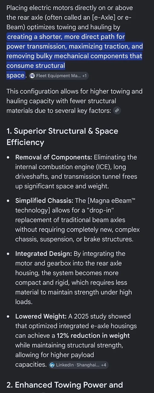

I am hoping slates official ratings are just liability jargon and not true limits (or even close)
Slate with all its structural strength and drivetrain directly on the rear axle is a suitable design for tractor trailer design,
Because of its design you need much less high strength raw material because the powertrain forces are all unitized in a small area, also reduces the weight and cost to make an extremely strong weight and trailing device as you can almost ignore the front end.

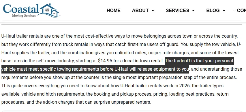

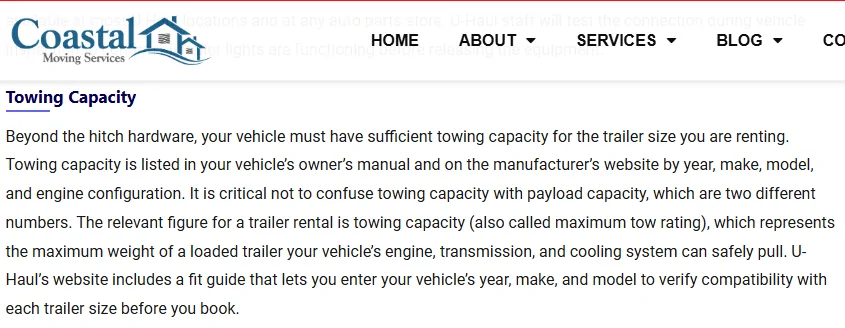

So back in the day, I use to winter store my Valkyrie interstate at my house in Maryland (not where I live now). I built a 8 x 8 shed in the back yard that was on piers and the deck height of the shed was around 24 to 30 inches (knee high). I built a ramp from 2x6 and some scrap bead board. The ramp was 18" wide and about 8 feet long. In the fall, I'd ride the big Valk up the ramp and into the shed; my head just cleared the top of the door header. I had electric in the shed for the battery maintainer. But that was back in my Evel Knievel days - lol.
So its not like I've not ridden a big bike into a small space like a pickup bed. I started on dirt bikes at 13, so I have no balance issues. I'm just not going to risk damaging a $30K motorcycle when I can rent a UHaul trailer for $28 (local trip - last time I rented one a few years ago).
If the Slate can't be upgraded, then I'll borrow a trailer from a friend or buy my own light-weight ride-on trailer. Cheaper than repairing a Bagger.

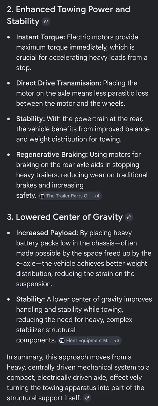

Love AI. "move from a heavy centrally driven mechanical system, to a compact electrically driven axle."
Since when is an electric motor, reduction gear transmission, battery, inverter, etc. not a mechanical system?

Dumass Googleheim's razor...
"Shall it not be validated by AI on the internet, then therefore it cannot be true".
Yeah everyone is focused on the ai link but not the fact being unitized near the rear reduces the amount of materials to build up trailering and support structures.
the hitch weight limits on normal trucks are highest the closer the hitch is to the rear axle, with a 5th wheel being strongest mounting directly above the rear axle.
Reduces lever arm forces and twisting forces on the frame to the front as well.
