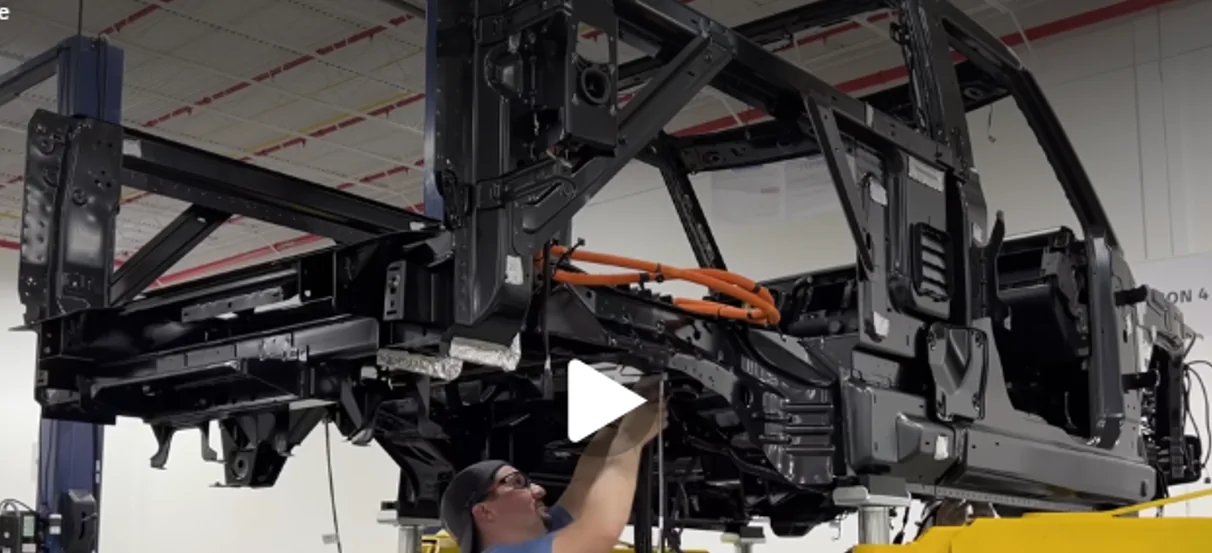

This is the ass end of the Slate's chassis from the Munro video (granted it is a prototype - charge port is on the right-side corner). Triangularly tie the receiver to frame end-caps bumper mounts and to the center tail piece and a 3,500-pound tow capacity is easily achievable. There are a lot of frame member joints to spread the load over. It's not papier mâché. (WHAT is papaiye' machaie'!) - LOL
106
220
Excellent shot! Crawling under the truck and checking out this part of the frame is one of the reasons I'm hoping to see it in person.

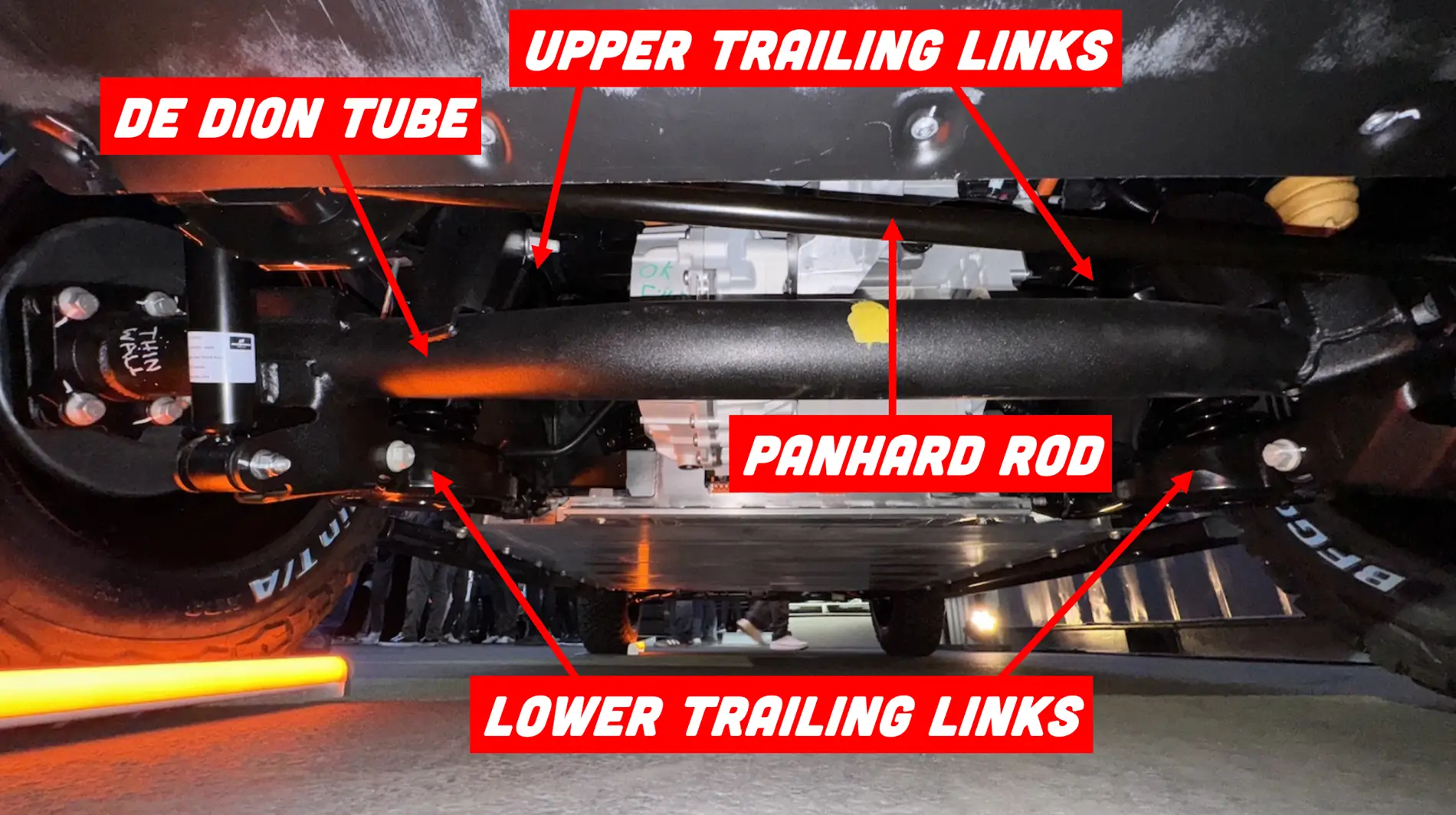

I also found these images from TheAutopian's suspension article from last year:
I imagine fabricating some complicated frame sleeves/boxes/braces to reinforce those frame rails from the rear bumper mounts over the spring perches all the way forwards to the trailing links for the axle. And adding stiffer springs and/or airbags. Triangulating between the bumper mounts and the middle of the frame is a good start, but with a 1000 lbs tow rating there's no need for those points way out back to support significant vertical loads or resist torques about the hitch mounting point.
