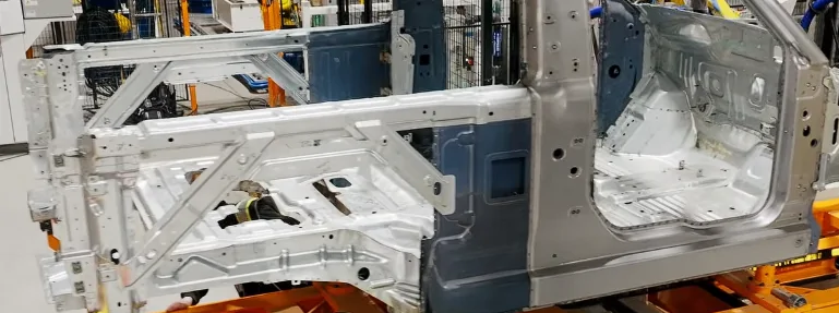

Yes, the much-maligned Cybertruck has a much higher tow rating of 11,000 lbs, but it began to fail at 6000 lbs of tongue weight. And yes, they had to use a forklift to hold the front axle down so the truck didn't just wheelie. Slate is rated for less than 1/5th of that, but if it's proportional, my perfectly ordinary travel trailer could break it.
The Slate and Cybertruck have very different structures. I think the Cybertruck's exterior is supposed to be a load-bearing exoskeleton...so, I guess the tow mount is just on the external structure of the bumper. I don't know how it's constructed (the video thumbnail implies "GLUE?").
The Slate has a more conventional internal frame.
I think any tow connector would be attached to that internal structure, rather than a bumper that's sort of on the surface of it.
I see no reason to think the tow rating would be "proportional" (just over half of the claimed rating) to the Cybertruck.
Aside from their structural differences and the relative difficulty of 6000 pounds and a bit over 1000 pounds, the point of the CT is to be a very bold, superlative vehicle with big numbers.
They're going to claim the biggest possible number they can, and I'm not even criticizing that, because it makes sense for what it is, and 6000 pounds is still a lot more than the Slate can support.
The Slate is marketed and designed around affordability and practicality. You know Slate Auto isn't targeting impressive numbers, they announced an electric vehicle in 2025 with 150 miles of range (since increased to 205 on the new LFP cells).
I think when Slate gives a number, they're erring on the side of caution/underpromising and expecting people will use (and sometimes exceed) all of the capacity they claim to support.
