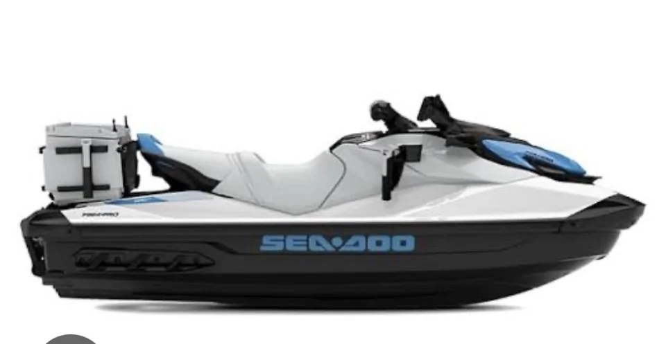

She a big girl but not that big. When I checked online a few weeks ago I came up with 1,275. Today I’m finding 1,100. Sea-doo FishPro Scout that’s with an aluminum trailer. Manages to do 50mph with my 235lbs big boy arse on it
I was going to say, I thought seadoo sparks were around 500lbs. I ride standups, so the weight isnt really a concern.
