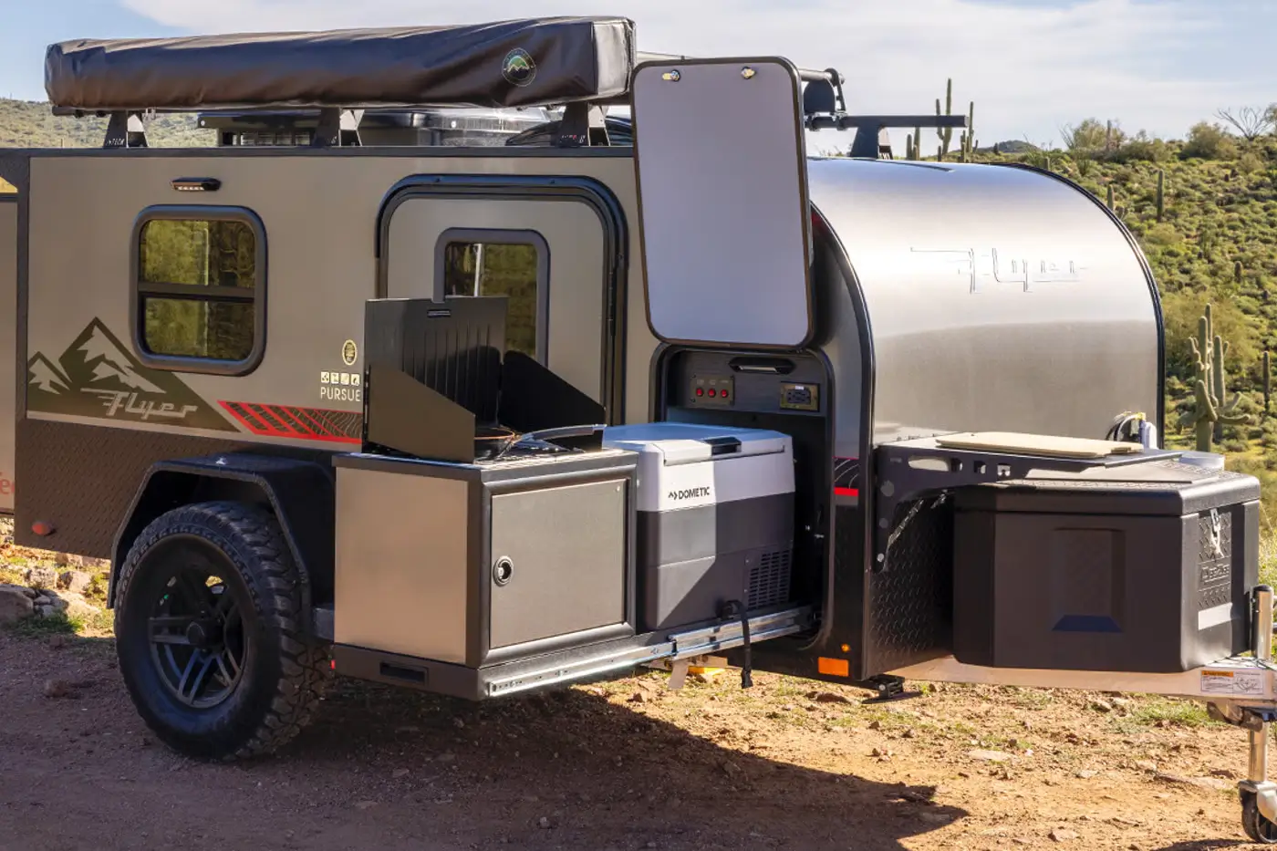

Thinking about getting a Intech 2027 Flyer Pursue Camper Trailer for camping with my Slate. I just have to make sure the overall weight is less than 2000lbs.
In the future, I like to install a Solar based L1 trickle charger on the roof to slow charge the Slate while enjoying the outdoors.
Intech 2027 Purse Camper Trailer
Slate Auto Pickup Truck Intech 2027 Flyer Pursue Camper Trailer 1785536624333-x8
Dry Weight: 1,195 - 1690lbs
GVWR: 2,200lbs
Net Carry: 510 - 1005lbs
F. Water 8.5g: 70.89lbs
20lb LP Tank: 37 - 40lbs

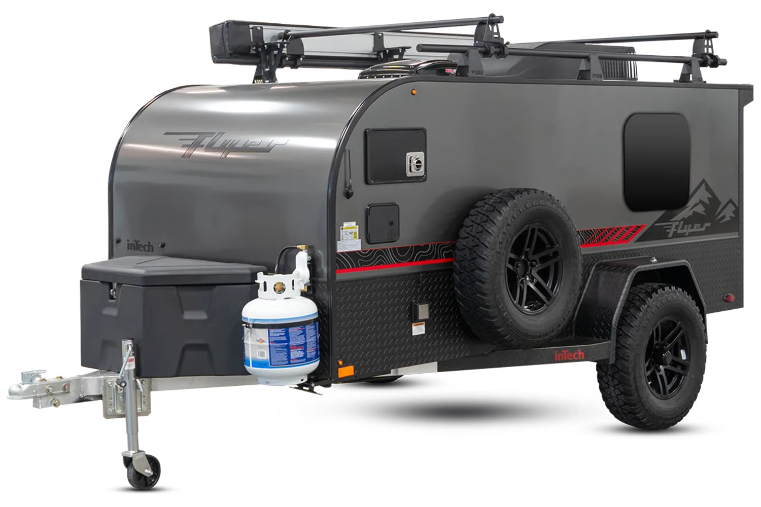

The specs say 1,195 - 1,690 lbs dry weight. Seems like quite a range ... and not all that much headroom for a 2000lb max on the truck.
Figure the dry weight depends on what add-ons you get with the camper like AC, pull-out kitchenette, or etc...
I am fine with the limited headspace, I figure this trailer would be more aerodynamic that other 2000lb trailers with more headroom.

Also figure what gear you will be carrying. Run into this issue on the forum of the lightweight trailer we have. Factory lists 2353 as dry weight, out the factory door with options was 2672, weight on a scale with food, clothing, camping gear was 3400. GVWR was 3500. Don't forget about tongue weight. Also the people towing with EVs usually cut the range about 40-50% while towing
