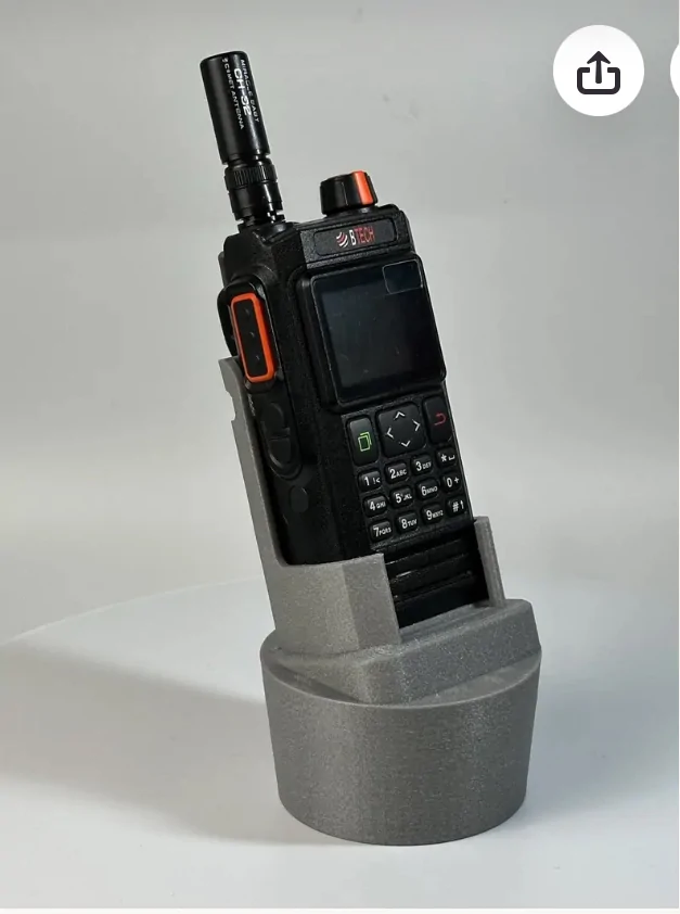

I’m thinking of printing a cup holder mount for my HT and using my 3D printer.

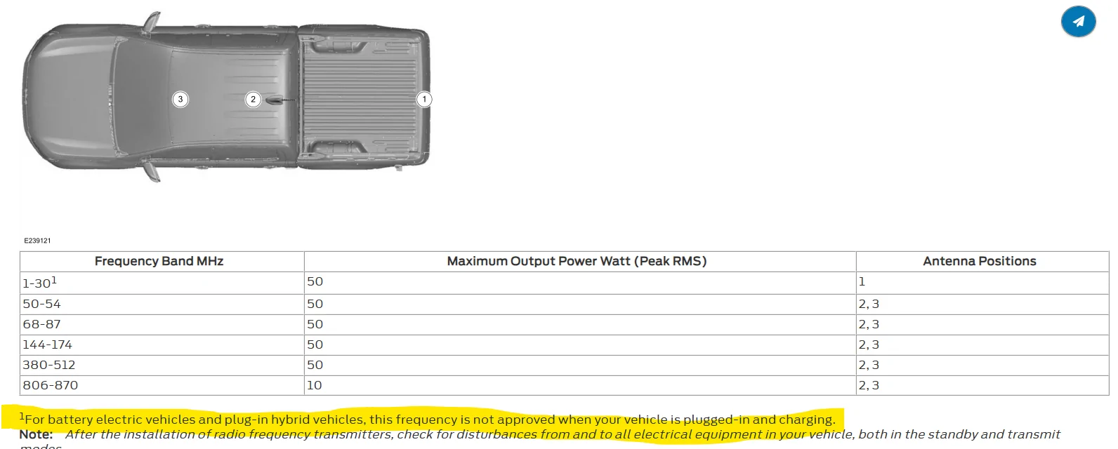

You may want to get guidance from SLATE before you install any radio/antenna. Ford is very explicit regarding where you should put antennas on a Maverick based on frequency. It's in the owner's manual. They also do not recommend using an HF radio when charging...

And the Maverick has a metal body. The Slate is going to be really tricky for HF. A half wave antenna should work but the antenna height more or less limits you to VHF/UHF. On the upside, you shouldn't have to worry about bonding body panels.

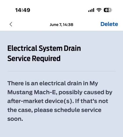

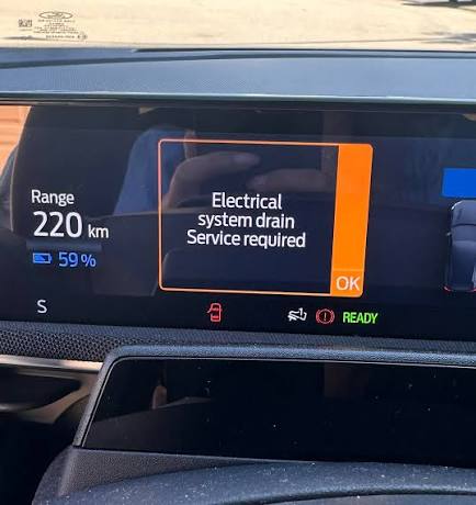

This is what happens when you connect simple 12V accessories to an EV:
Slate Auto Pickup Truck Is any one planning to use any ham radio gear in their Slate? (I am!) {filename}
Very interesting!
So a mini VHF/UHF mobile unit in the Slate (or my Model 3 for that matter) will likely overload the 12 volt battery system? Is your mustang complaining with the radio just being connected to the 12 volt and powered on, or when receiving, or when transmitting?
