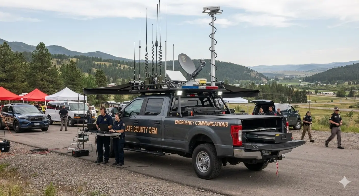

I’m seriously thinking about building a good communications/loadout setup in mine. I haven’t really gotten into the ham radio scene yet, so I’m not super fluent in all the terminology, but a lot of people I work with in the UAV world are into radio, RF, antennas, and comms gear. It honestly makes me jealous and has me wanting to learn more.
Right now I’ve mostly been building out my EDC/truck packs with gear that can mount to T-track, MOLLE panels, etc. I could definitely see a mobile radio setup becoming part of that system, especially for trail use, road trips, emergencies, or just learning the hobby.
Something like this but scaled do
Slate Auto Pickup Truck Is any one planning to use any ham radio gear in their Slate? (I am!) image_7efd0632
wn?
