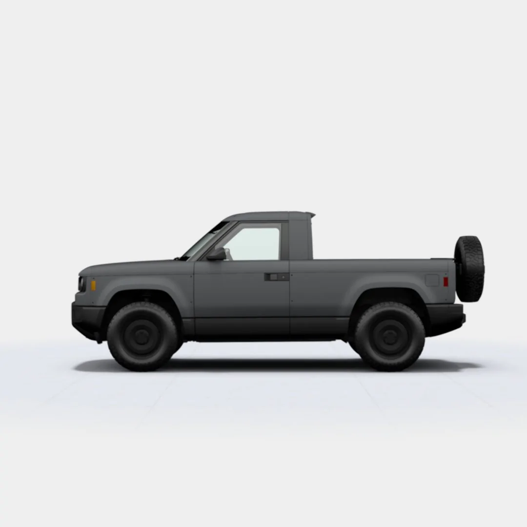

I have decided to go with the lift kit and bigger tires than the base stock tire. Adding a little weight with the rear tire carrier as well. How much would range be effected by these changes? My commute situation does not make this a true concern, but I am curious if someone with more knowledge than I can provide a ballpark number how much this would impact range.
Going to be awesome, these are most “to and from” work, school, play.
Not a major mover.
Looks good! 😊
