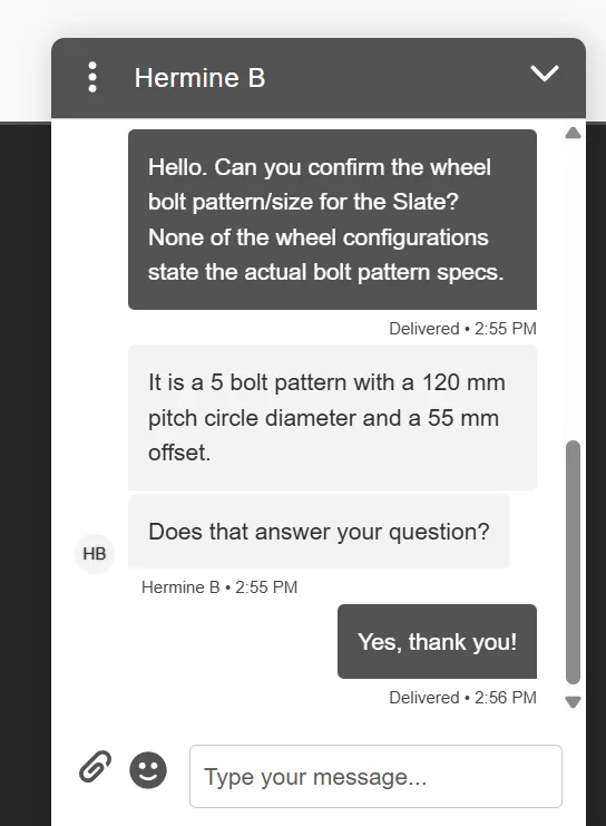

The best we know right now from some pixel sleuthing and checking out aftermarket rims that Slate has featured on some demo vehicles is that the current wheels are 5x120 lug spacing, 17x8.0, ET25 offset, with a hub bore of less than or equal to 72.56mm. They are of course welcome to change any of that prior to finalizing the design.
phidauex
Nov 24, 2025
292
698
Boulder, CO
Ah, interesting, 55mm offset on the stock wheels. I wonder if that means the hub is spaced differently than on the prototype vehicles, or if they intentionally allowed for 30mm of poke on prototype builds - that would give a bit more of an aggressive look without being crazy.
Either way I think that a range of offsets and widths could work, it looks like there is a fair amount of room to work in there, and the fact that it is designed for a 31" tire means there should be a lot of choices.
