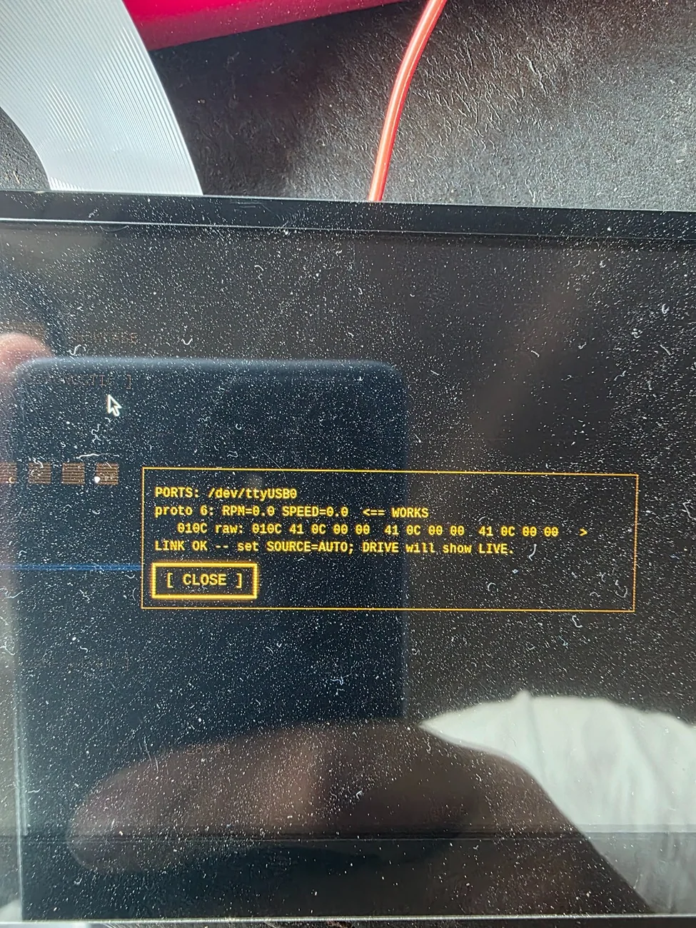

If anyone actually knows coding please help ai is good but God is it annoying personally if I had the money id pay someone XD also got it working on the pi except for the obd stuff and haven't tried the nav just get yet. the TV function is working but needs some tweeks. was testing the obd2 seems I was having flaky communication where it would read some times but not all the time.

ok update got the obd2 to finally link up just need to actually tweek it a bit to be faster and be more accurate with the information but i drove it and it did display accurate speed just took a hot second to do so

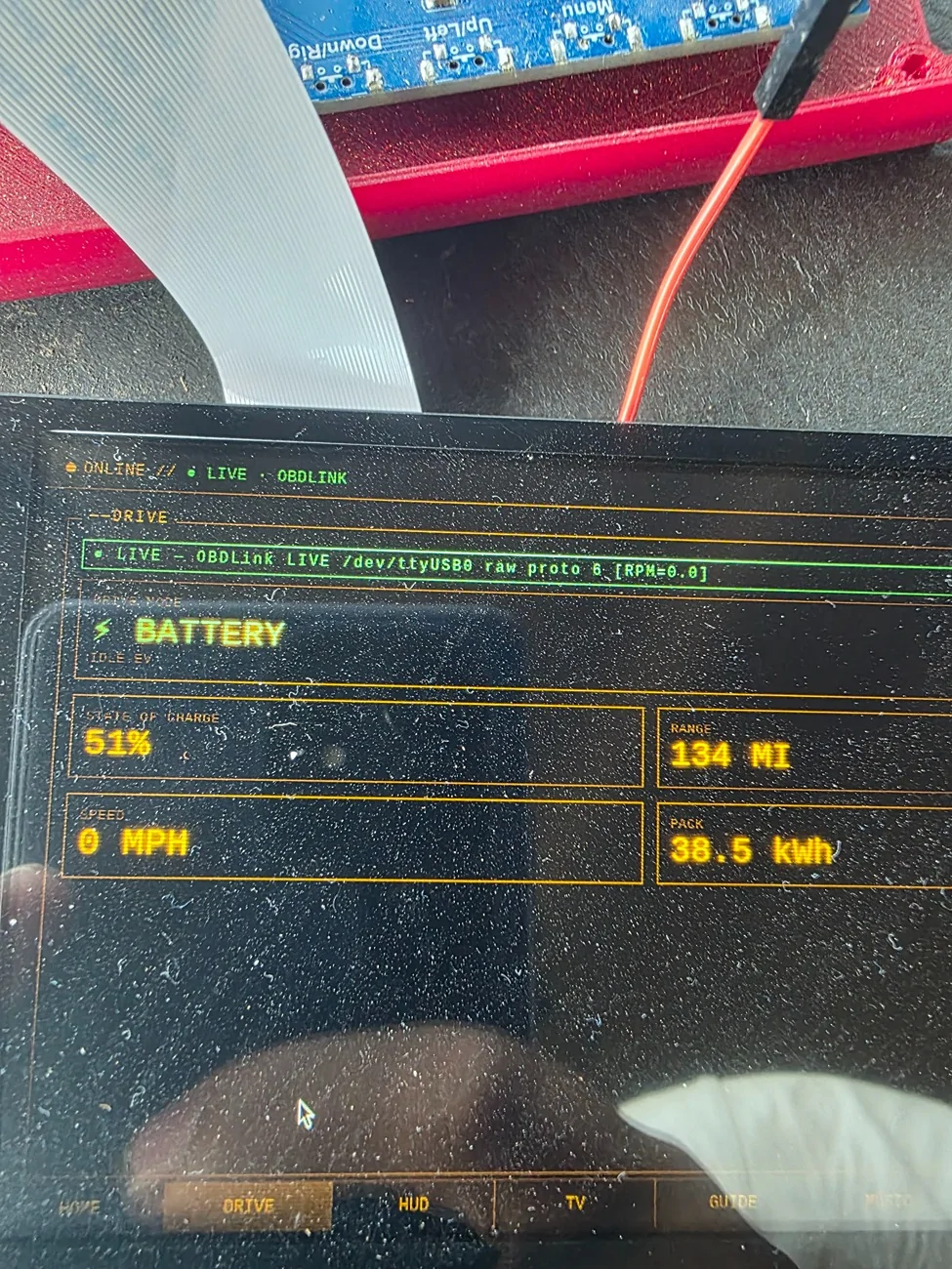

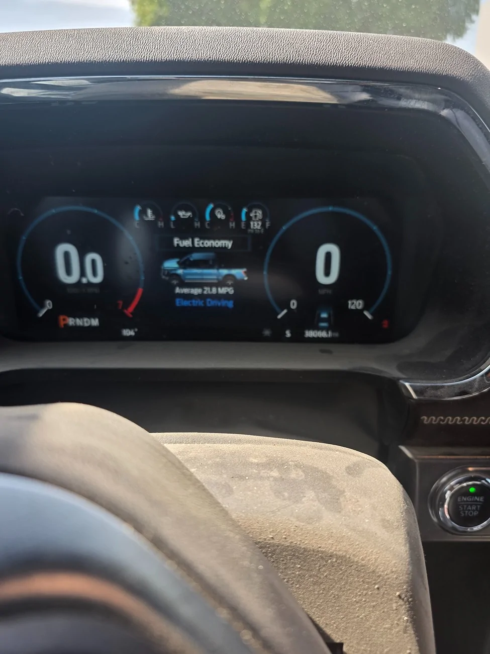

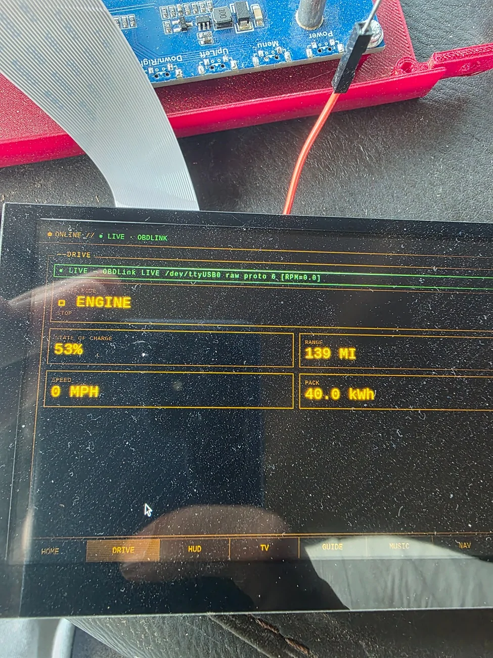

OK got the obd2 side working only thing is it shows the temp in Celsius in the drive menu and Fahrenheit in the hud menu but looks like everything else is working since i have the power boost i can also see the battery % and well i have to guess that that is accurate since ford doent tell me the actual %
