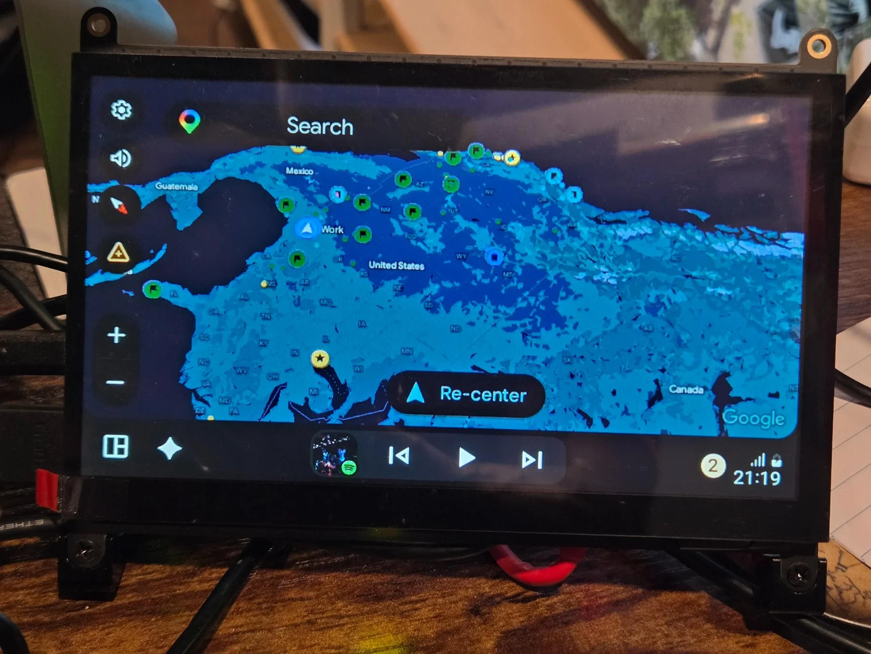

I messed around for a couple hours and got a spare Resp Pi 4 and a display to launch Android Auto and my phone connected to it.
My ODB-II dongle is coming from Amazon in a couple days. I'll take a look at your files shortly.

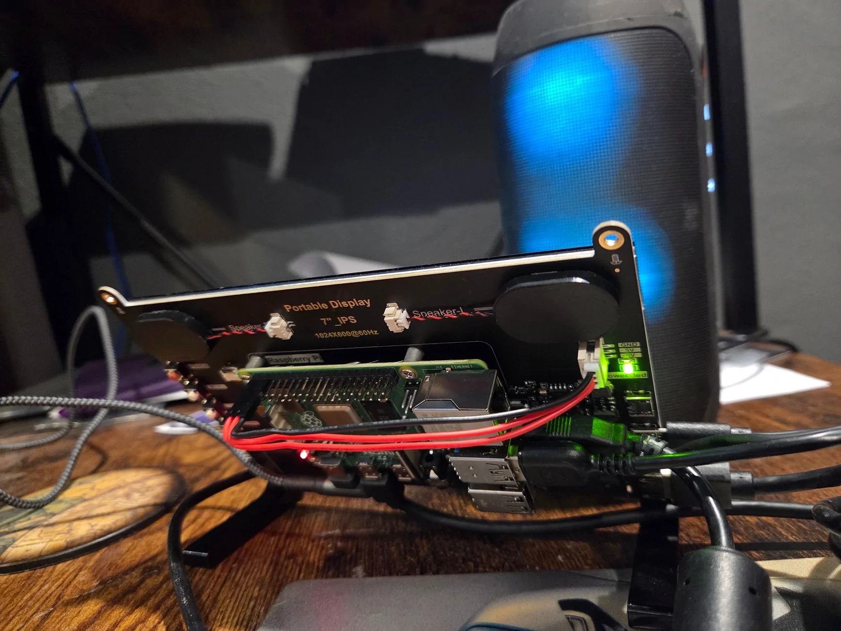

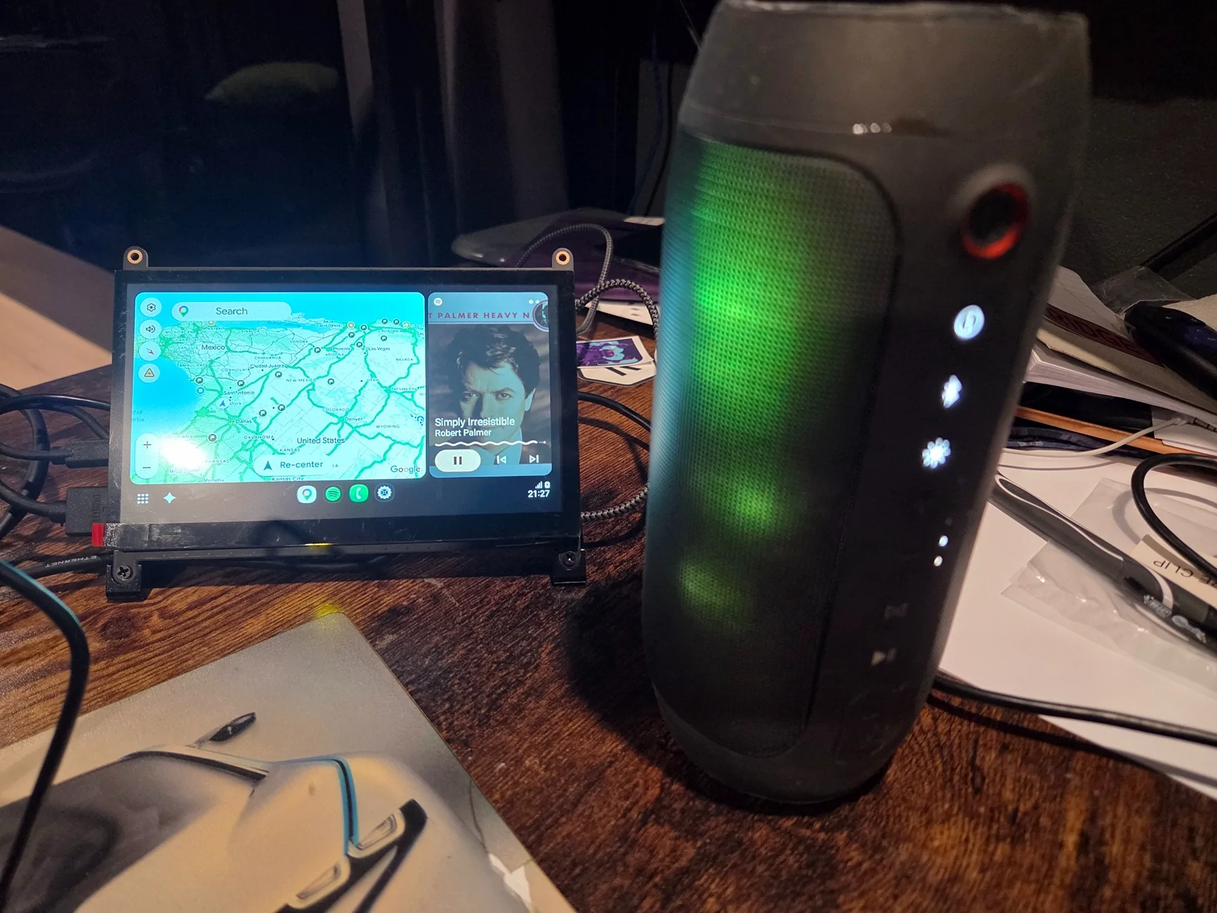

I think I hit a snag.... I can connect a BT speaker to the RespPi and stream Spotify from my phone Android Auto to the Pi over USB. However, wireless Android is out of the question as the BT bandwidth is not sufficient to stream audio and pull telemetry from the ODB dongle.
The setup will have to be wired audio via the headphone jack or an audio hat with better DACs.
