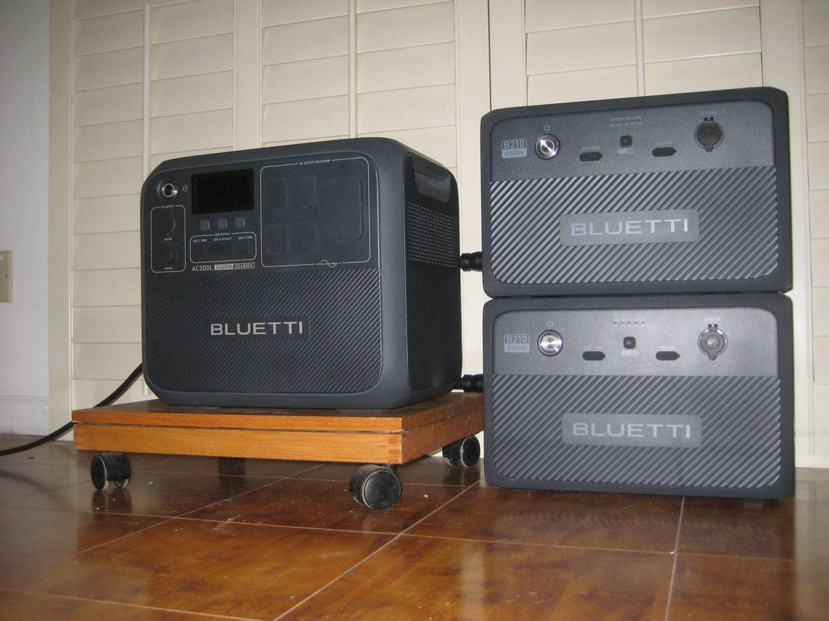

If you want to simply be able to run higher current draw electrical appliances (power tools, induction cooking devices, etc.) when you're out and about with your Slate, you might want to consider the purchase of a portable power station (I call them solar generators, or "solgens," because virtually all of them now have fairly decent built-in MPPT solar charge controllers built in these days.) There are several well known brands to choose from these days: Ecoflow, Bluetti, Jackery and Pecron come to mind.
Pictured below is the larger modular Bluetti system I have: an AC200L "head" unit that can mate to 2 of the B210 expansion batteries, also shown . . .
Slate Auto Pickup Truck No Vehicle to Load or Outlets in Bed/Frunk AC200L_B210_01_W
6.3kWh is what this combo is rated for. Since it's all modular, each part is a stand-alone station in the 2kWh range, although the expansion batteries are DC-only on their outputs. These things get bigger (whole house backup size and, most recently, 240V capable,) as well as smaller.

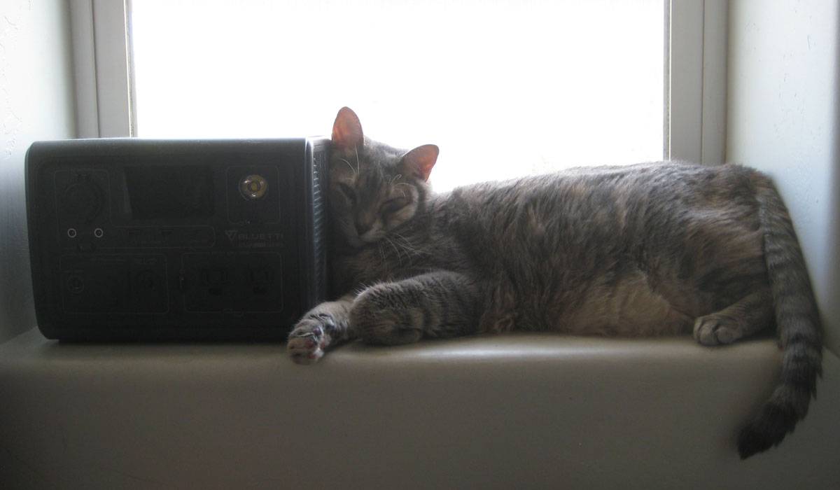

I also have a couple of the EB3A units, which mate perfectly to a single 100W solar panel and has a 600W inverter, as well as a host of DC outputs (cat not included) . . .
Yes, those are definitely good options and would be a little more flexible than plugging into the truck itself at times. Still hope it maybe has outlets as an added option
