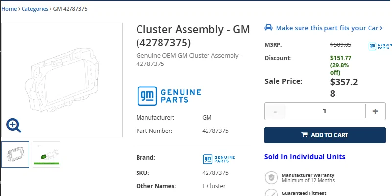

You should be able to obtain a new display from the dealer that can program it with the correct odometer reading. Depending on your specific vehicle the MSRP for the part should be $500-$600. and the labor to replace and program it should be in the $300-$400 range.
You are looking at around $1,000 to repair that. based on my rough estimate.
you may be able to purchase it from a site like this and they may be able to program it for you, but i would contact them to see if they offer that. https://parts.chevypartspros.com/parts/gm-cluster-assembly-42787375
