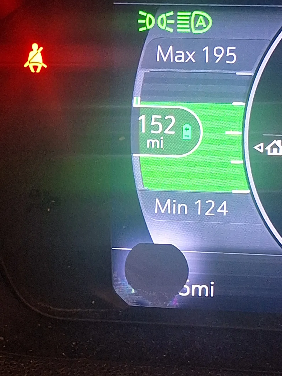

Not Slate, but EV related. I have a 2023 bolt ev. Right where the odometer it started to go black. I touched it and made it worse. Right now it is

Primary control module is where the data is counted and stored. A diagnostic tool can still pull the correct value, and replacing the screen will restore your milage back to accurate reading. Might be a nightmare on a Bolt.

Not sure without checking but i believe the cluster can be reset. If not, every single state in the U.S. Has an exception form or process that can follow the vehicle. I believe the OP may be in Indonesia where it may not matter. I would definitely go with a used part and file the exception paperwork. I suspect through the dealer it will be closer to $2000-$2500 to replace.
Edit - I see by the previous poster that the cluster goes blank so the dealer gets to make their money on a reset Even with a new cluster, so go used And save $$$$

Hmm, in just 3 years and the screen fails? Displays are not considered a 'wear item' or related to mileage. I wonder it the OP can try seeking a warranty claim exception. The 2023 Bolt comes with a 3-year warranty on electrical systems which should cover the display.

As others mentioned this is an LED screen problem related to either physical screen Module, but also potential software driver issue for the hardware .
The Slate could suffer similar problem with their LED cluster. I think this type of behavior is a potential screen issue for any LED monitor. Which is when an LED monitor spends the majority of its time showing a near constant image pattern. The constant image projection causes an accelerated wearing of the diodes causing faster degradation and burnout.

Not Slate, but EV related. I have a 2023 bolt ev. Right where the odometer it started to go black. I touched it and made it worse. Right now it is not getting bigger but I am worried it will get worse. There is about 75,000 miles, I can't tell miles without the odometer. What would cause this? How do I fix this? Would I be able to resale it like that? How much would it be to get it fixed? I need the car to last intil I can buy a Slate Automotive pickup. Please see attached picture. Thank you! Is there another way to read the miles? Thank you!
Looks like a dying LED screen. If it was a Slate, hopefully there would be a University module telling you how to swap out the screen. Hopefully it's not contained with whatever stores the odometer reading as That's probably some sort of dealer only swap for the mileage to be accurate. I would imagine you just can't replace an odometer/ dash assembly module with one that's possibly just lower mileage. I'm sure there's some sort of security hoops to jump through if it isn't just a screen replacement.

This actually looks like it may be physical damage. Like the screen was impacted or stressed at that bottom corner and the glass inside cracked. I see similar but worse all the time on laptop displays in stores. For some reason some people think they need to try to fold the screen closed, though it's in a bracket and can't close, and look at what the back of the screen looks like, and others do it intentionally.
Anyway, yeah, that shouldn't happen on a dash display, so first try and see if the manufacturer will cover it, if not check how much it costs to reprogram a replaced cluster, and work from there.

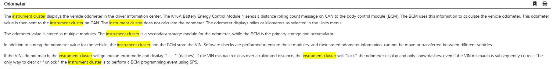

Here's what service information says, basically. No, and yes... The BBCM and Cluster both store the odometer and VIN data, but the BCM is the official record. If either the VIN or ODO do not match, the Cluster will not display the ODO reading.
Therefore, I will stand by my recommendation to not purchase a used module for this specific vehicle.

I doubt that the actual screen is locked to the cluster. If you purchase a used cluster just the lcd panel can be removed and swapped in your existing cluster. It may or may not be soldered to the control board but soldering is easy. YouTube has videos. i always look at component level repairs and not just full module swaps.

Not likely, most consoles only allow 1 pairing to 1 vin number, in any case most of this is going to be dealer only ,,, and then you need to find one with a Bolt specialist.. Many Chevy and GMC dealers don't have one. In my town only one of ht e3 GM dealers can do anything with a Bolt.
