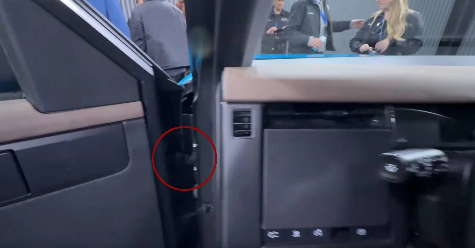

Unfortunately, I think you might be right. I tried to find Youtube videos that show the door hinge mechanism , but it seems to be glossed over in all the influencer type videos. I did find this still image though and it seems like it's a traditional hinge with the little pushrod arm that dampens the swing mechanism and further recessed hinges behind it. Looks look like there's a little electrical conduit between the door and main chassis that's made from a cloth type material instead of the usual rubber grommet we see on all cars. Of course that might change.

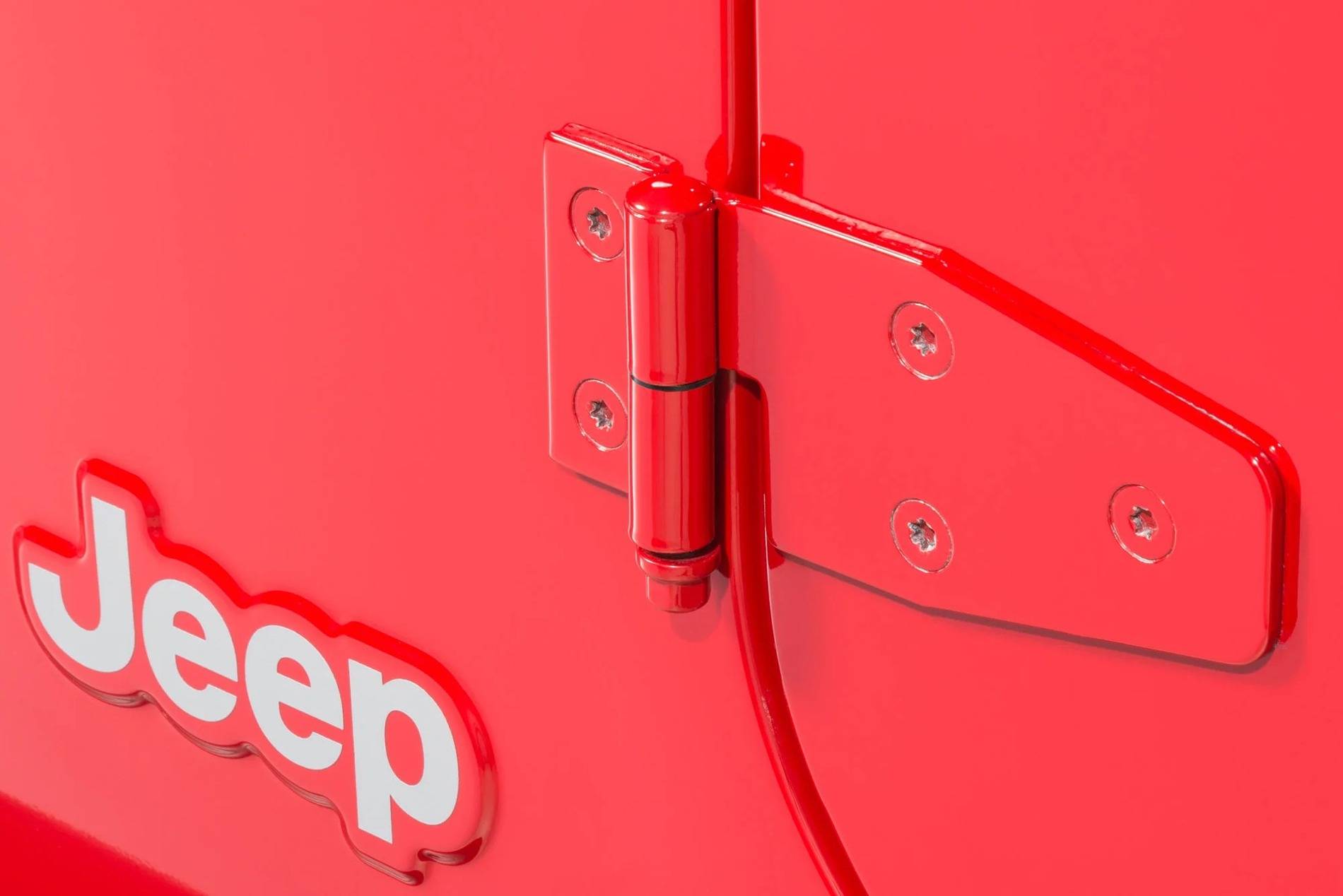

Yes, I've also taken many a pause looking over various vids and pics and the process looks complicated for door removal. If they're serious about that feature, a redesign is in need, otherwise almost no one will ever do it.
With what looks like a typical bolt-on design you see on almost all car doors, I think you would need to have one person stand and hold a door up while another person unbolts it. No good. What a PITA. That is not DIY-friendly.
The Wrangler's door hinge design is simple and primitive and perfect. You just remove 2 small nuts from the bottoms of the threaded hinge pins, pocket them, disconnect the door swing check strap from the jamb, and lift the door straight up about 3 inches and you're done. It literally takes a minute to do. I love how easy it is to pop doors off and on whenever I want.

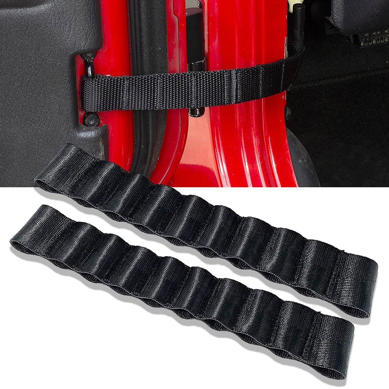

Also, another thing I love is the adjustability of the check strap. It's just a simple polyester strap with notches sewn into it so you can adjust the door swing by shortening or lengthening the strap. It takes a second, no tools. I adjust mine often depending on parking situations.
