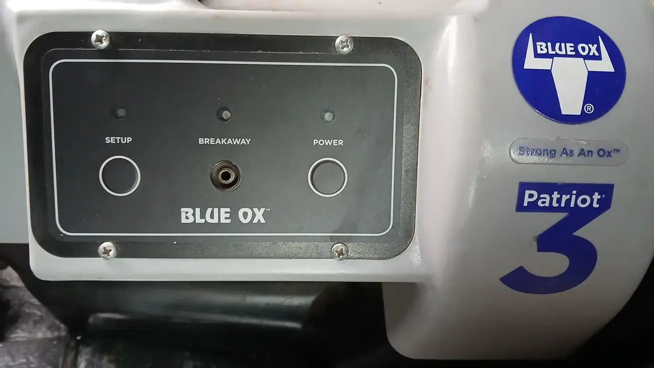

I Flat Tow my Nissan Frontier with my Motorhome using a Blue Ox Patriot 3 Braking system. It uses a sensor on the dashboard to send a signal to a device in my truck that manually presses the brake pedal to Slow The Vehicle..
Wouldn't this charge the truck every time I hit the brakes? I really Want to Enhance the capability Of Regenerative charging While I tow it with my motorhome Period For example Using an app Let's say I wanted to add 10 percent Resistance To charge The slates battery or have an AI app that knows when to regenerate for example going downhill or just taking your foot off the gas Etc

You're right that this is a problem. The Patriot (and others) draw energy from the towed vehicle's battery in order to operate the mechanical foot. But you want the low-voltage (and the high-voltage) system turned off in order to tow the EV four-down.
This will be an issue for the Slate or any any other towed electric vehicle that requires on-board braking. (Not all towed vehicles require on-board braking. It varies by state, however. Here in the four-corners states of the US southwest, the magic number is 3000 pounds US.)
One solution would be to add a simple 12v battery to the EV, and to keep it charged up via wiring from the motorhome's umbilical cord. Not a rocket-science arrangement.
That matter is solvable, but I think the bigger issue is going to be whether the EV is towable at all four-down. If the Slate is not four-down towable, I plan not to purchase.
