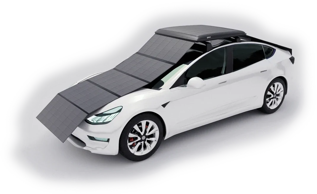

I haven't seen this specific setup covered in this forum. Apologies if I've missed it.
I'm very seriously considering installing a collapsible solar panel array (500-600 watts) on the roof of the Slate, and collecting the power in a stand-alone battery generator, with the intent of dumping the stored charge into my Slate via Level 2 charging every day or two.
I'm not an engineer, but I am a technician, and pretty good at electro-mechanical DIY. I also acknowledge that there's a wealth of smart people in this forum, and I would love to hear any thoughts or suggestions about this idea.
Use-Case: My daily commute is about 16 to 20 miles, mostly freeway. I'm thinking about attaching the solar panels in a collapsible or folding configuration, using Slate's roof rack, either with or without SUV kit. I haven't decided what standalone generator to use, and I'm open to a piecemeal approach if that's more economical or efficient. I'm thinking of putting the equipment in the frunk.
Tell me your thoughts! Any and all comments are welcome and appreciated.

Someone will be along shortly to do the math, I'm sure, so I'll leave that to them.
My only question is, is there an advantage to putting the gear on the truck and driving it around all the time, vs keeping the same setup at home and optimizing the solar orientation of the panels? My gut says the extra weight & drag of the array and battery generator is likely to offset any net benefit. I could see it being a worthwhile setup if you were going off-grid for a while though.
I totally agree, and I would prefer a stationary setup, but I don't own my own my home, and therefore can't establish a semi-permanent setup.
My hope is that I can accumulate enough, passively parked in full sun everyday, that it substantially reduces my need to use Level 3 charging, which would otherwise be my primary source of power.
If it even just made it so that I could just fast-charge less often, that would still be something. Ideally, it's a self-contained solar-powered car, which feels like I'm set free from the grid, to a limited extent.
Maybe it's pie-in-the-sky.
