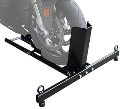

I don't like how they show the front tire of the motorcycle hitting the center of front bulkhead. Once you cinch the straps down that is a lot of force in middle of that bulkhead. I would put the bike on one side or the other and turn the front wheel into the corner where the bulkhead meets the side of the bed. That will be a much sturdier place to put that kind of load. Bikes are very stable carried in this manner.
