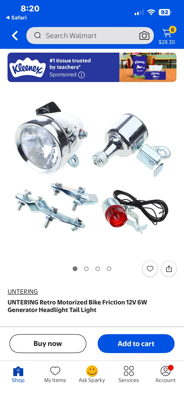

I don’t know if you are old enough to remember but back in the 60’s they a generator that laid against the wheel of your bicycle to generate electricity to power a headlight.
oh wow Walmart still sells them LOL. I guess some things are timeless.
It was my favorite bike gadget. And you could feel the drag!
Modern hub dynos are amazing. I bike commute and have to recharge my lithium-ion headlight and taillight weekly in summer or every day or two in winter, which isn't too onerous, but a buddy showed me his SON hub dynos this summer and it's incredible. It's only a couple watts, you cannot feel the resistance at all. Highly recommended. Old bottle dynos rubbing on the wheel were neat but suck in comparison.
