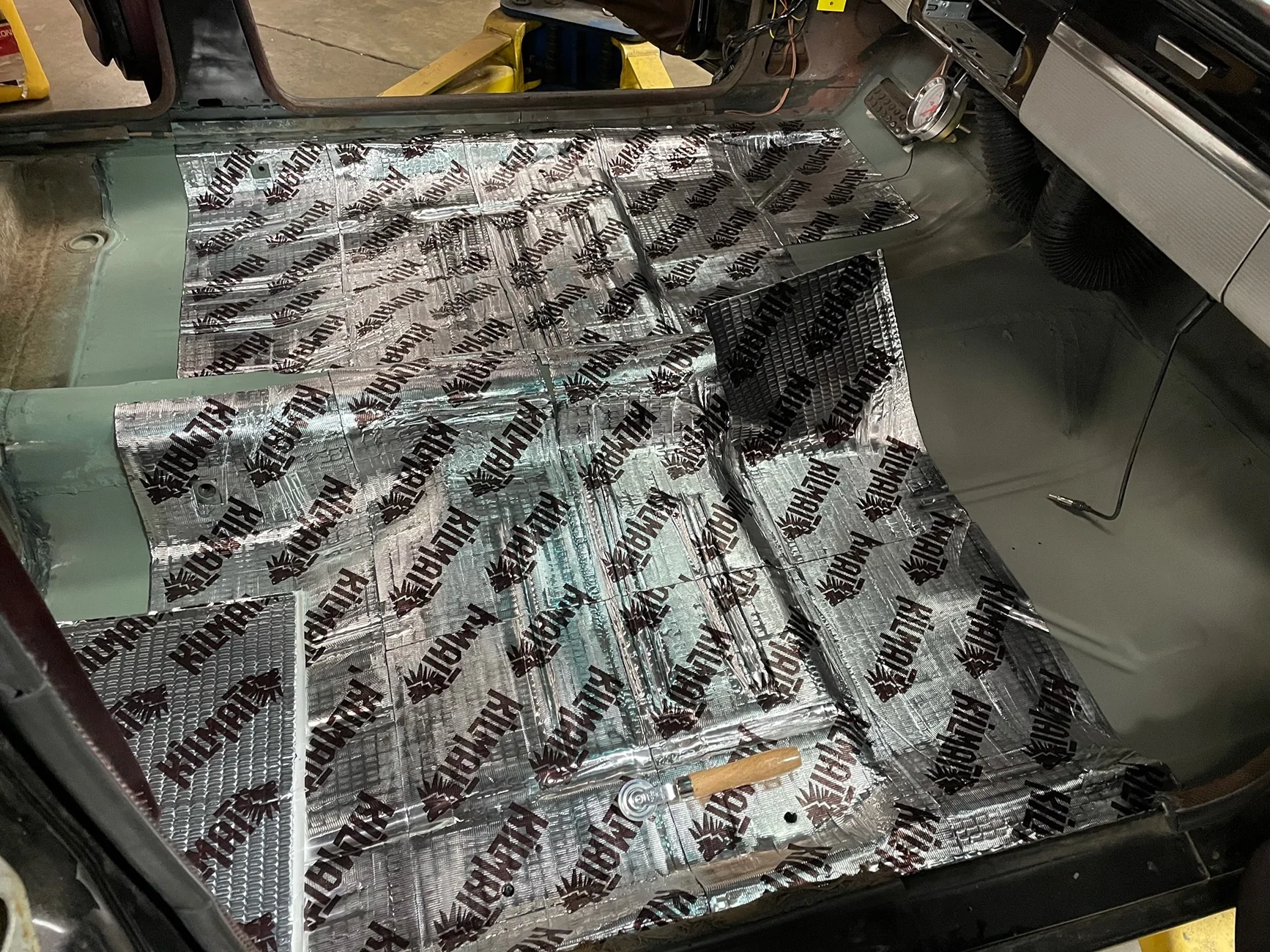

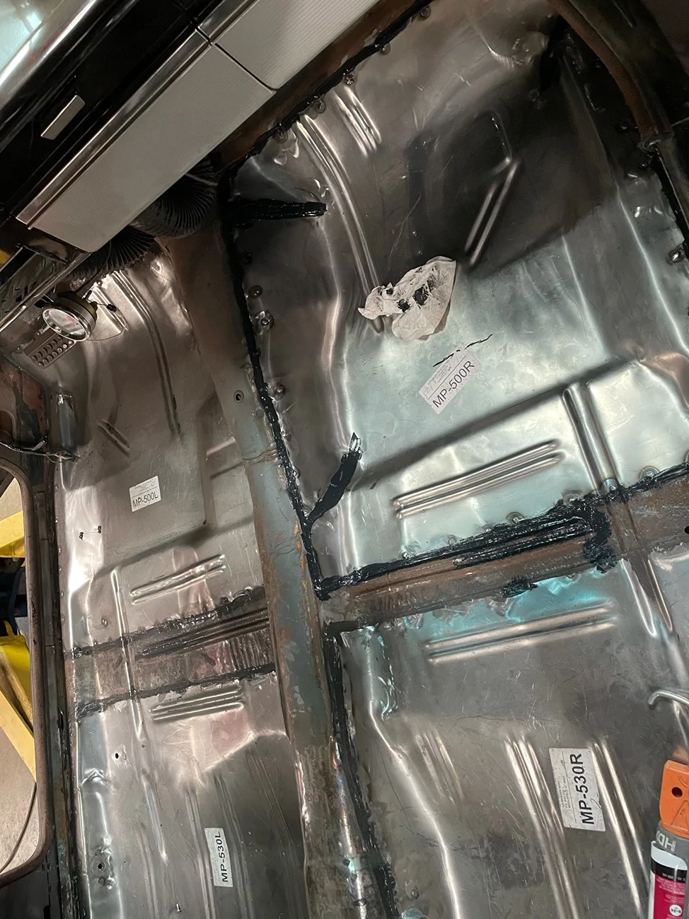

On my Dart, after replacing the floor pans, I installed 80mil Kilmat. It’s one of the many butyl rubber and aluminum sound deadening products out there. Primarily this was due to the fact that the exhaust ran directly under the driver’s feet, which made a drive quite uncomfortable after a while, or when going along the freeway. It additionally served the purpose of taking the rattle out of the sheet metal. I installed a couple of squares inside each door as well so reduce the rattle, as well as the hood and the trunk. I never removed the headliner and installed it in there.
It was highly effective at both heat and noise control, and I’m curious if anyone’s given any thought to adding any sound deadening products to the cab of the Slate. I remember seeing on a review from April 2025 of the SUV products that there would be no sound deadening on the ceiling of those, but in the maker it looks like there may be upholstery on the ceiling of the truck. Being made out of a presumably pretty thick piece of reinforced plastic instead of thin sheet metal, I’m not sure it’d do too much for rattling, but it may serve to reduce outside noise. One of the thicker acoustic foams under the headliner if there is one or behind where dash speakers might go could be of use.
