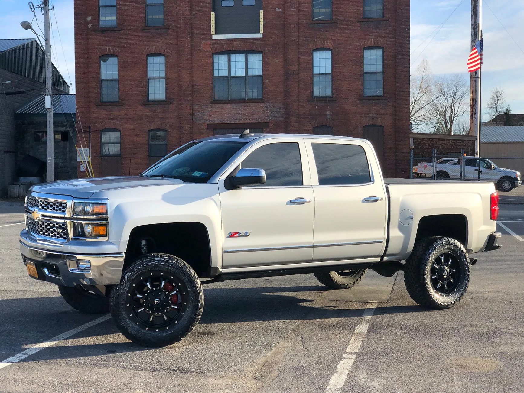

I think that trucks first got large square wheel arches because on something like a off-road dump truck that gets 3 mpg on a good day and realistically less trundling around the excavation site through the mud, aero is irrelevant and sheet metal is expensive. This became recognized in popular culture as "tough" and "manly", and now there are absurd Tonka trucks on the road that look like this:
Slate Auto Pickup Truck Suspension Poll: Lifted, Lowered, or Standard Height? 1123350-2-2015-silverado-1500-chevrolet-pro-comp-suspension-lift-6in-fuel-assault-black
When you think about it from first principles, it's like they didn't even try. I understand the look because I'm a member of our society and aware of the ways in which this photo has a masculine appeal, but an alien would not design that truck in that way. There's no reason for those arches to be squared off when they need to fit round wheels, there's no way the suspension on that truck compresses even close to the top of that opening. That truck in particular with those $$$ alloy rims and tires with aggressive sidewall tread but low profile and low surface tread, currently shown in a city parking lot probably hasn't ever been on a 2-track much less driving through the woods.

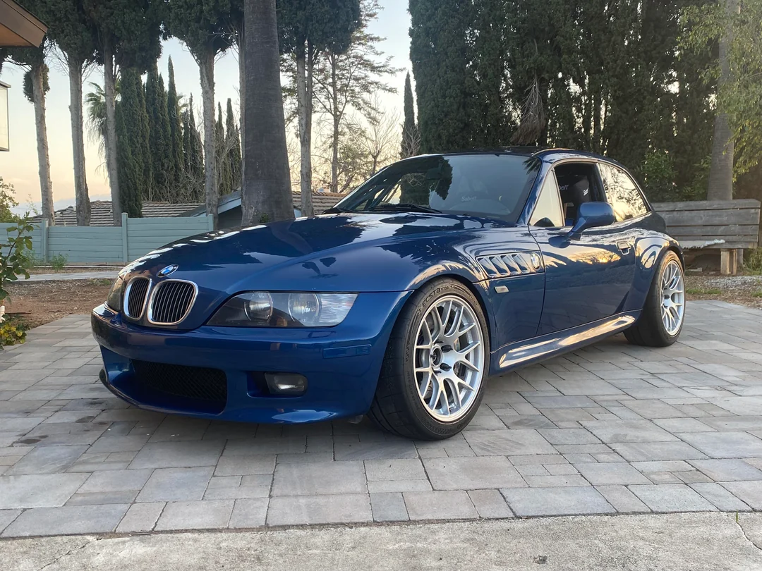

In contrast, this makes sense:
Slate Auto Pickup Truck Suspension Poll: Lifted, Lowered, or Standard Height? 2001-bmw-z3-3-0-track-build-v0-unovsfa758xa1
Round 28" wheel, round 29" hole. Why would you do it any other way?
Because that only works when the suspension and steering both don't move much. Manufacturers are generally required to ensure that there is at least 6mm (1/4") clearance between the tire and all body/suspension at combined full steering lock and full bump. What brodozers and stancebros do are both entirely irrelevant to the reasoning behind factory opening size, shape, and clearance.
Flat topped openings start to make more sense when you look at the actual 3D motion and spacial constraints, especially as travel and/or steering angle increases.

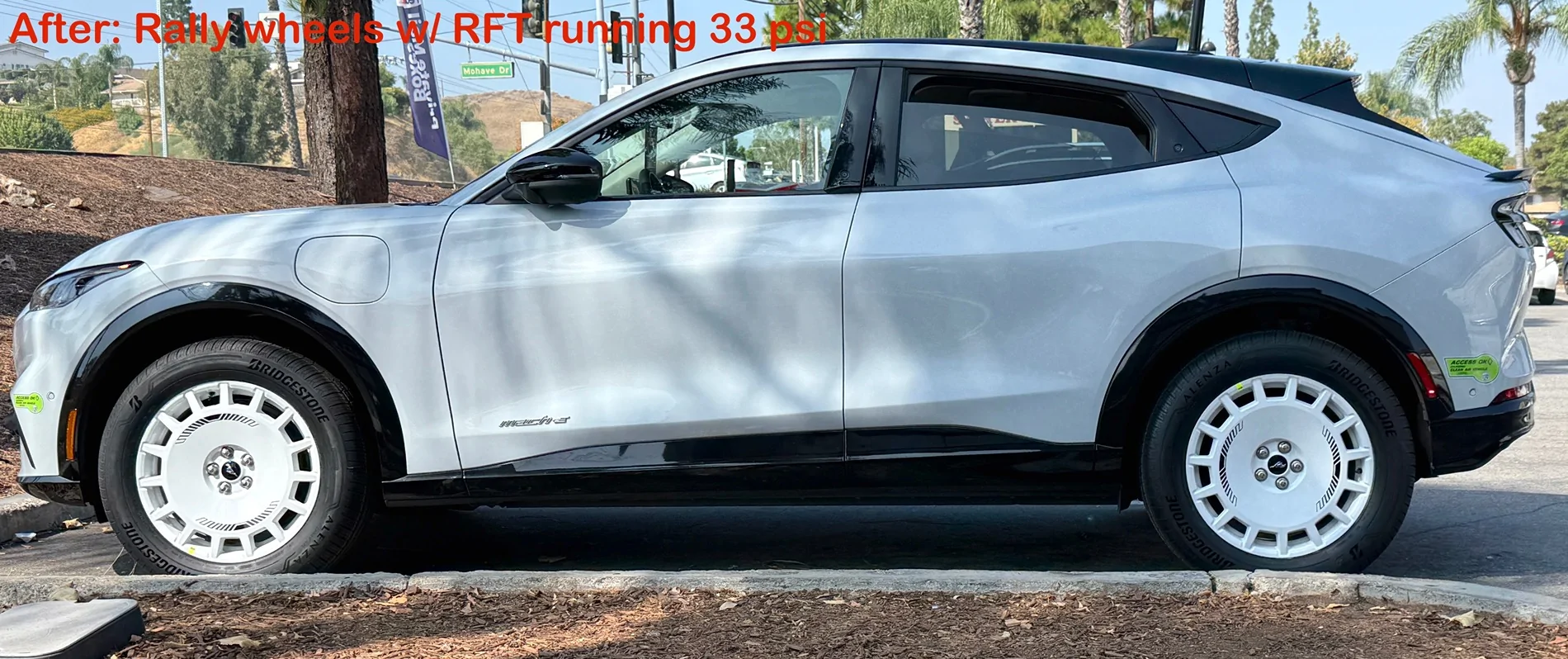

My current EV - Ford Mach E has a 1.5" lift springs which is needed to clear the larger +4 sized RFT tires which have the off road Rally wheels from Ford.
It sits taller, has more ground clearance but suffers from range loss due to the increased drag height and tires.
