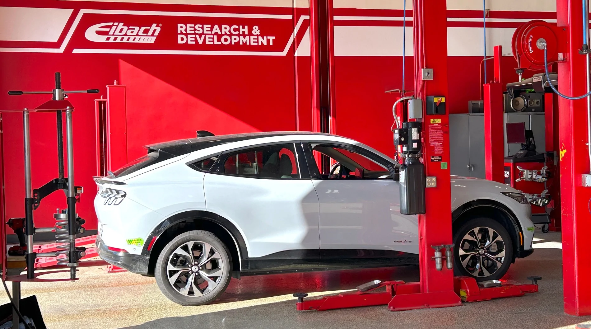

I'm hoping Eibach makes some springs. Stock or slight lift but with better dynamics. Or bigger sway bars. I'll have to drive it before I'll be able to determine what it needs.
Yes, I love Eibach!
Have Eibach lift springs and sway bars on my Mach E and love them.
Rides more comfortable and planted.
Much better ride than the OEM springs and sway bars.
