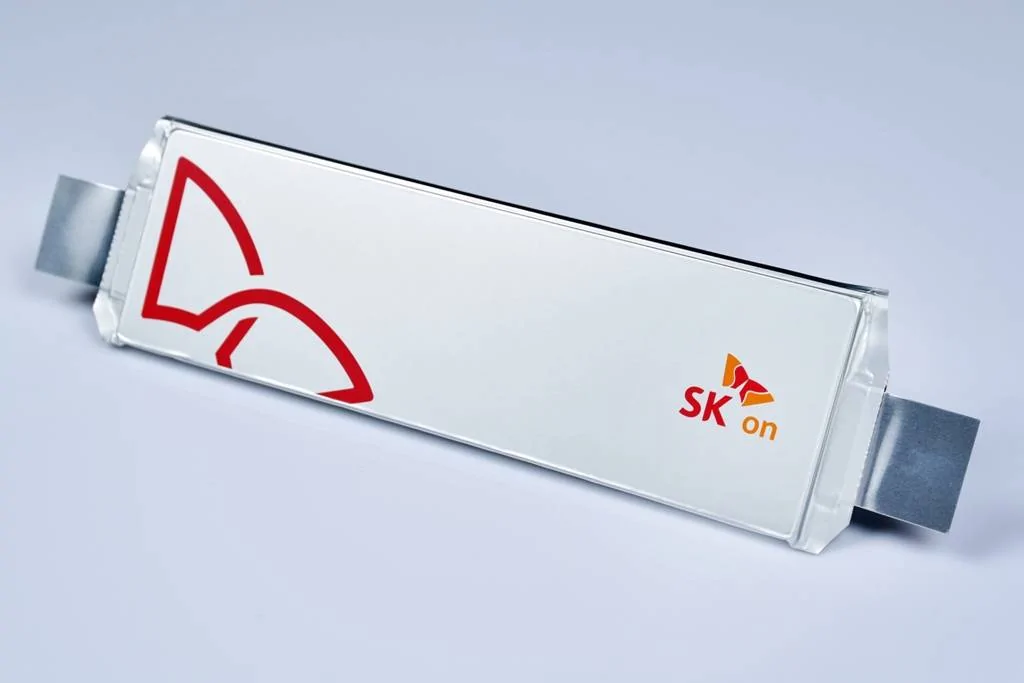

Slate Auto Pickup Truck Tech talk about NMC cell chemistry and charging parameters SK_On_NMC_02
