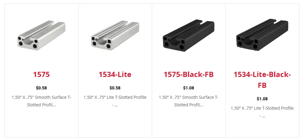

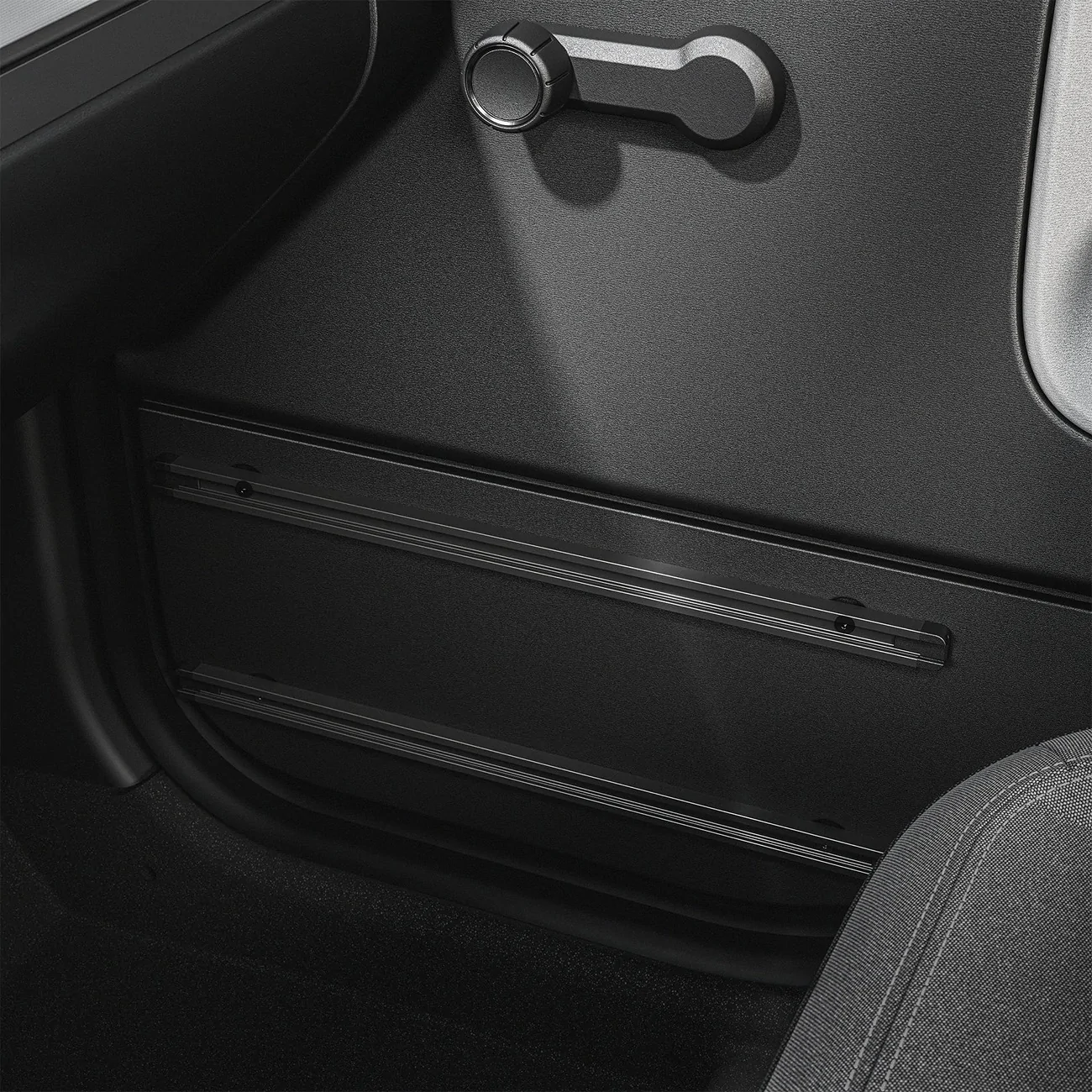

Looks like a bunch of the hold-down/attachment options both inside the cab and in the bed are various lengths of T-rail. Is that just extruded aluminum like this
Slate Auto Pickup Truck Tell Me More About This T-Rail You Speak Of 1782421629178-ra
described here: https://8020.net/framing-options/t-slotted-profiles.html?dimensions=5565
and from another provider here: https://www.tnutz.com/product/ex-1575-black/?
By the way, the prices you see above are per inch, not per foot.
Seems perfectly reasonable inside the cab and in the bed if the loading was appropriate. It doesn't seem like a great option if the load is directed along the slot, as you'd be relying on how tightly you cranked on a knob or a bolt for friction.

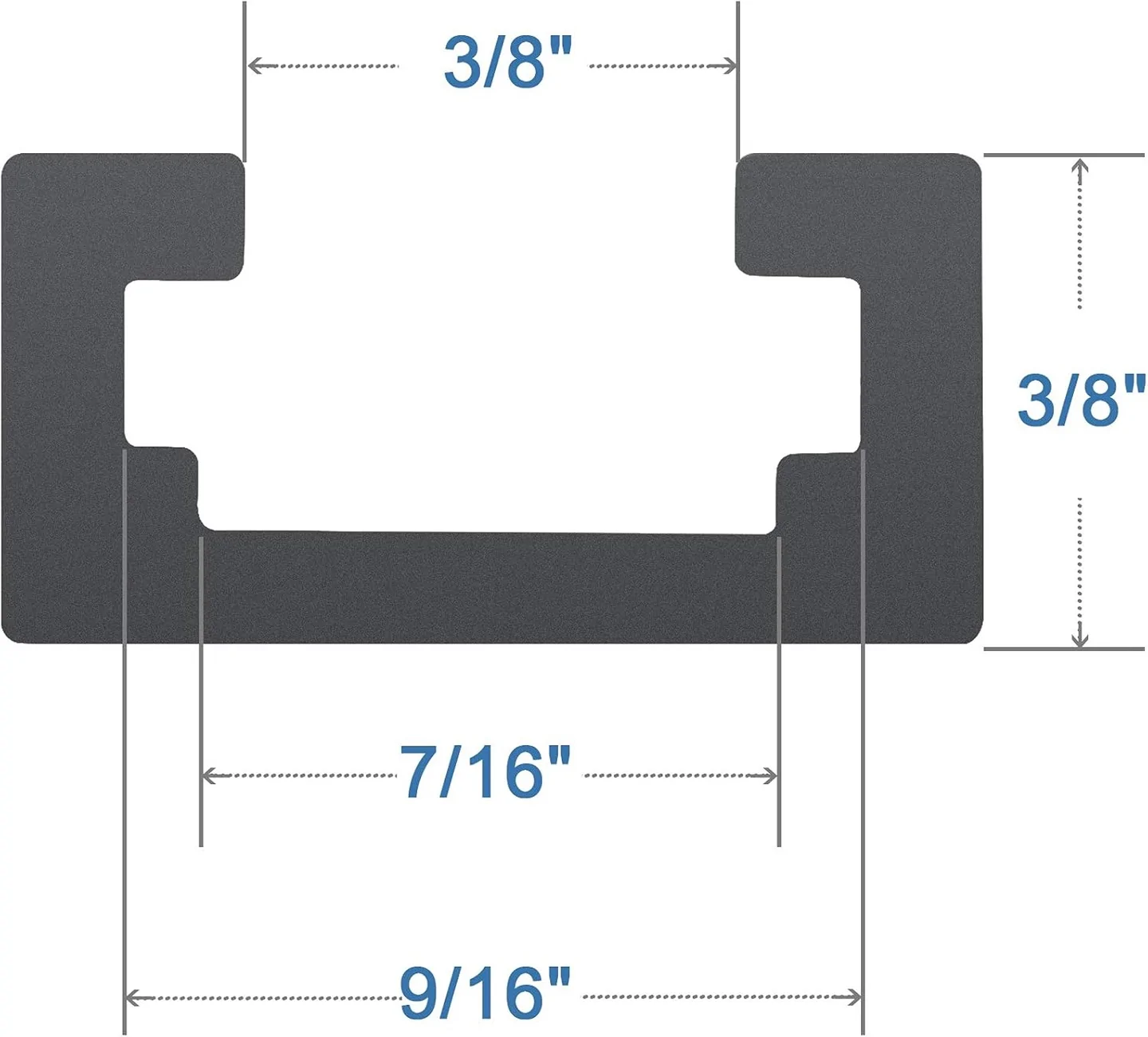

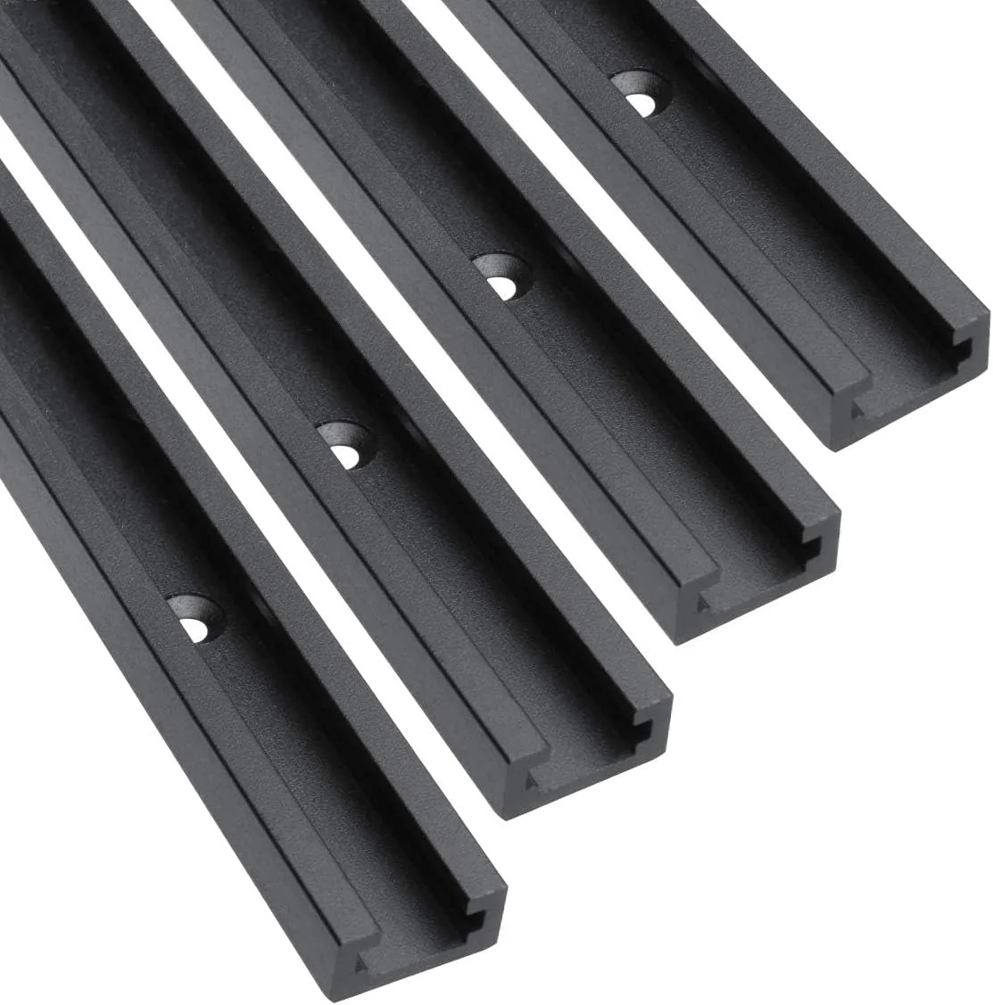

I doubt it's an 8020 compatible extrusion profile. Those use metric sized connector bits.
I use 3/4" t-track for making woodworking jigs, and it looks much closer to the squared off cross section seen in the configurator.
Slate Auto Pickup Truck Tell Me More About This T-Rail You Speak Of NAACCIU023primary
Here's some detail pics from an amazon t-track listing. Not saying this is the exact dimension of the stuff Slate is using, but I'd be surprised if they're using a different profile as this is pretty ubiquitous.

What is unclear is the panels underneath the T-tracks. Are they unique to cars that have ordered the T-tracks, or is it simply the base trim piece and the track screw to the face?
I'd be surprised to see them stocking this many levels of interior trim pieces, but simply bolting T-tracks to the face of a trim panel sounds very "hillbilly" to me (apologies to any hillbillies I've offended)
