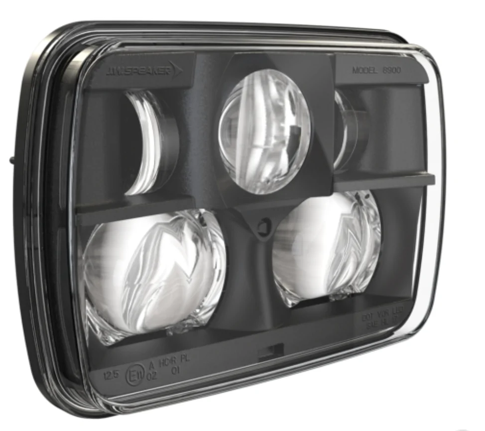

I have these JW Speaker 8900 Evolution headlights on my Tacoma (replaces the 5" x 7" square sealed beams in the 1997 model before they got polycarbonate units), and holy cow they are great. I blanched at the price at first, but they are excellent headlights - bright, but with a very clean pattern, clean cutoff, no diffraction patterns, and a perfect high hi-beam.
Slate Auto Pickup Truck The Autopian sits in a SLATE 1774916124493-x
https://www.jwspeaker.com/products/led-headlights-model-8900-evolution-2/
If the Slate takes a standard 7" round form factor, some of these models would be worth checking out.

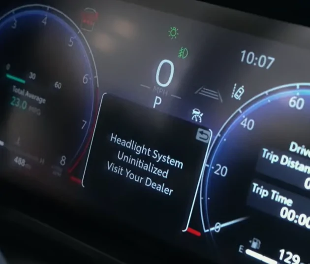

Edit: Just let us avoid whatever this is:
Slate Auto Pickup Truck The Autopian sits in a SLATE 1774918481319-fr

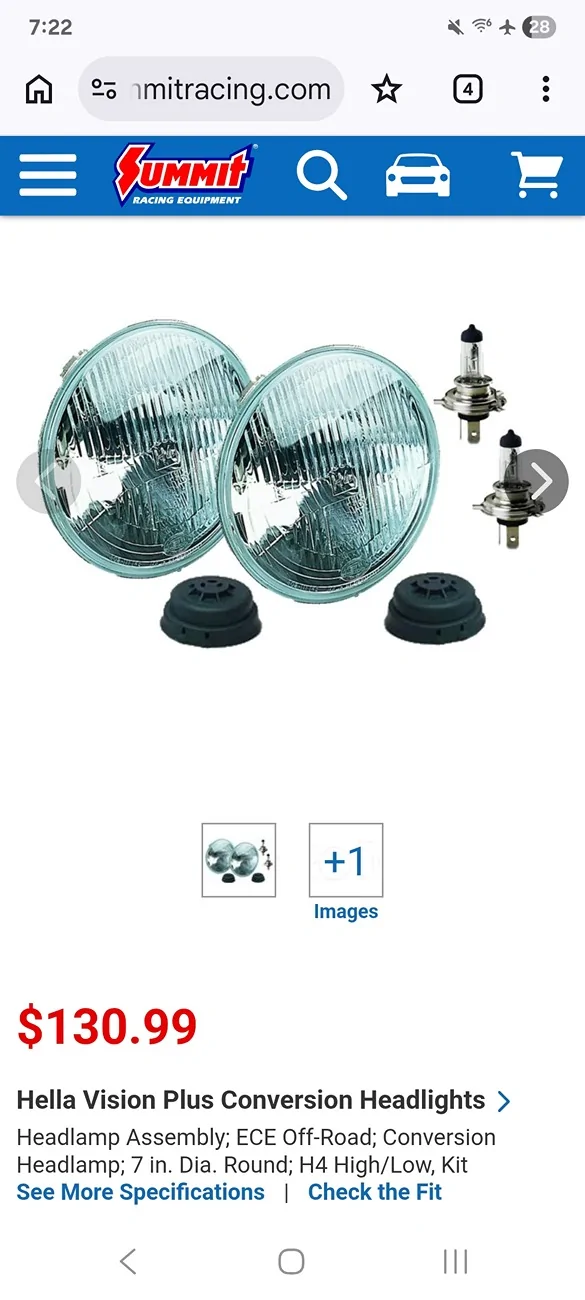

Over the years I have great results with using Hella European headlamps in my older cars that took standard sealed beam incandecent headlamps. With Hella they make an 80/100W halogen H4 bulb that fits these globes. The lighting pattern is great as is the volume and brightness of the light projected on the road.
The Hellas are glass headlamps, so no worry about opaquing after 5 or 10 years of UV exposure like modern car headlamps are afflicted with.
Slate Auto Pickup Truck The Autopian sits in a SLATE Screenshot_20260331_072234_Chrom

The Hella headlamps are great but illegal at 80/100w for road use in the USA though. Not that that stopped me :) . The hazard for modern vehicles with electronic switching circuits is they are not rated for the higher currents. A standard 55w lamp draws about 4A each, a 100w lamp draws 7.4A each. With older vehicles, the switch may get warm, but with a solid state switch, you might let the magic smoke out.
Something else I have been thinking about with the Slate is what will the overall 12V power system be capable of supporting. After adding a decent stereo, uprated headlamps, offroad lights, ect. will the 12v system be overloaded? Is Slate going to be equipped with a accessory power interface, like what Jeep did? I have not seen anything other than a comment on the connectors being proprietary, which is not a good sign. I will probably put just a radio in mine, but I know a lot of people on this forum will want to add other power accessories as well.

There will be a DC/DC converter that will drop from the HV pack voltage down to ~13.5V for the LV system. Not sure what the rating will be, but typical ratings are in the 200A to 350A range. The LV battery is connected to that system as well, and it is charged by the DC/DC when needed (though we'll determine Slate's logic after release).
I'm sure there would be enough capacity for halogen lights if switched by a relay, but I'm not sure why you'd use them. There are some very nice LED options now with better beam patterns, better high beams, and no bulb replacement schedule. My JW Speaker headlights have been on the Tacoma for 8 years now, always parked outside, and look brand new.
