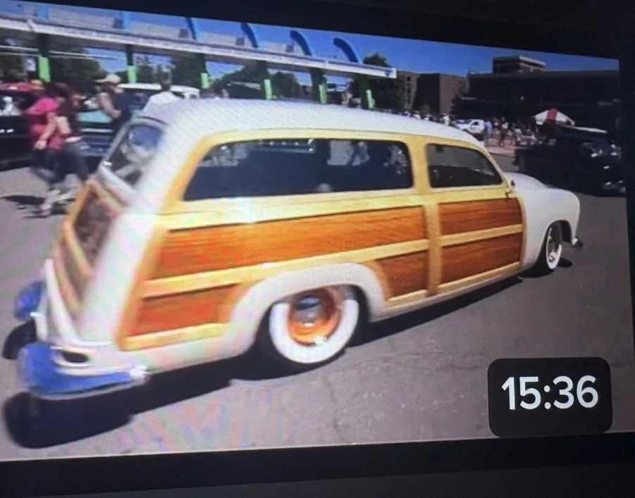

I was thinking about something like this. 😄
Slate Auto Pickup Truck Thoughts about woodgrain on the sides? IMG_4753

That grey grain look int the image in photo 2 made me think of a damascus steel look. You could do that, there are wraps on the market for it. You could even do the rainbow looking damascus titanium look.

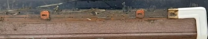

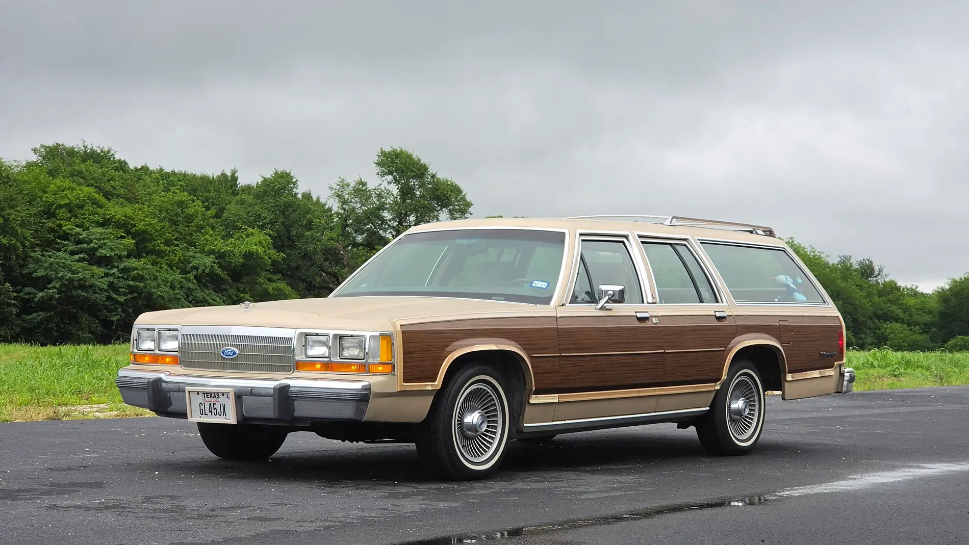

I can tell you from the wood panelling on my car it's pretty much all what is now 3M's archetectural vinyl. The 'trim' around the outside is alumium that is also wrapped in a different wood pattern. The easiest thing would probably be to make some custom mouldings and bond them to the panels or through-hole mount them. Mine are all attached with plastic clips to what look like little nail-heads welded all over the body with through-hole mounts on each end.
Slate Auto Pickup Truck Thoughts about woodgrain on the sides? 1780727763619-jt
You can see the top layer of the vinyl peeling on my trim.
Slate Auto Pickup Truck Thoughts about woodgrain on the sides? 1780727660707-t1

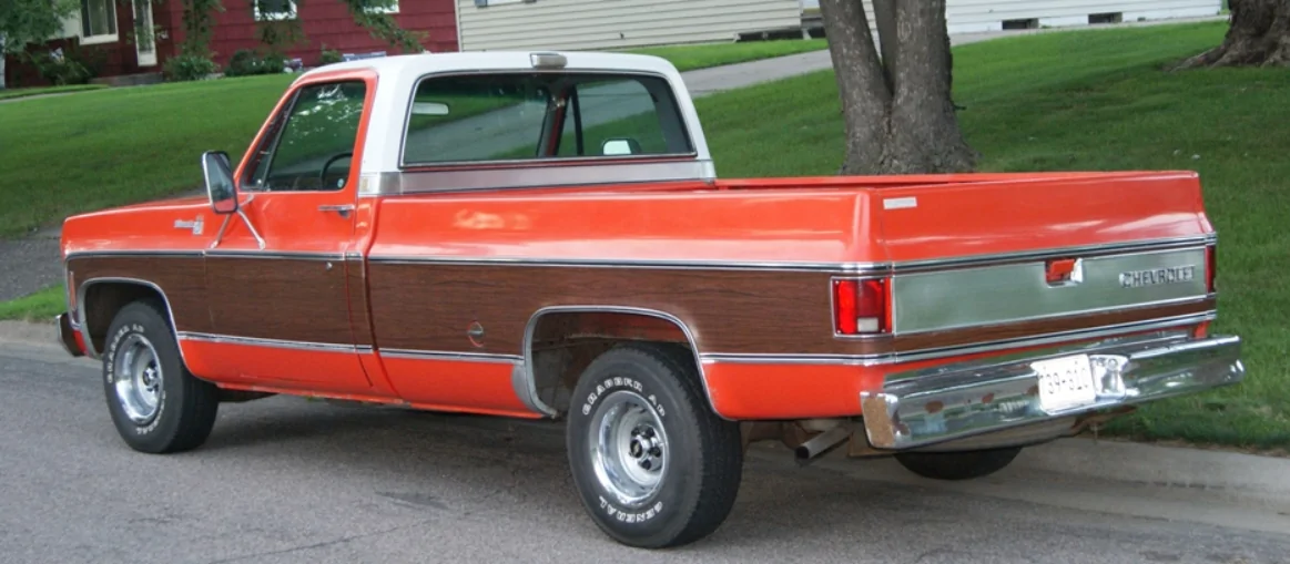

Chevrolet offered a woodgrain exterior on the C/K pickup in the mid 70s, so your idea is not unusual. In fact, it might be a fun way to bring some nostalgia to your build.
Slate Auto Pickup Truck Thoughts about woodgrain on the sides? Screenshot 2026-06-08 184805
