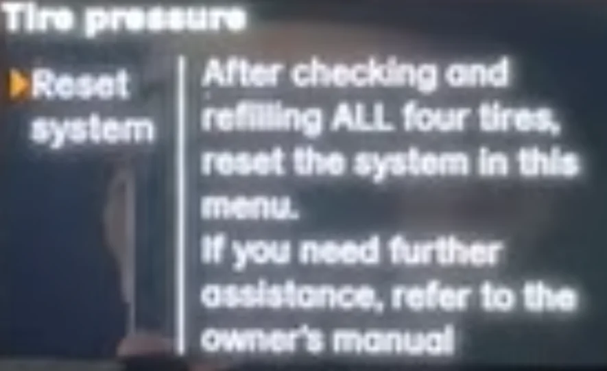

I saw that short-form video that breezed through the dashboard menu system, and as I interpret it, the attached screenshot conclusively confirms that it has indirect TPMS.
Indirect TPMS, where the system monitors wheel speeds to detect tire issues by virtue of the fact a low tire has a different effective circumference, uses a baseline that you set by making sure everything is nominal and then telling the system "this is what counts as normal". Actual pressures are not known, so obviously, none can be displayed.
On the other hand, direct TPMS has pressure transducers transmitters for each wheel. As actual pressures are known, they would logically be displayed, at least in a tire pressure menu. Pairing, wheel assignment, etc. would also come into play.
I already figured it would be indirect TPMS, as that's just software using existing already-required hardware, but the menu makes me completely certain. While direct TPMS would tickle my brain's data-loving center, I'll admit that the convenience of indirect TPMS's simple baselining function makes the practical side of my brain sigh with relief -- tire rotations or swapping on a spare just take one simple reset to bring everything back to nominal.
Thanks for using the CSI zoom and enhance. I couldn't make that work. Good find.
It'll also be nice for swapping in winter tires for the northern owners. One of the big gripes from the 2nd gen Honda Fit owners was swapping to their wheels that had the winter tires would freak out the always-active TPMS system and disable traction control.
