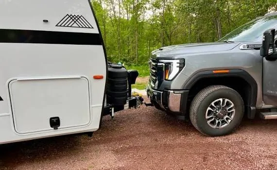

I like the trick of putting a hitch on the front of the truck and pushing the trailer with the front. Great visibility and you don't get your drive wheels in the water. Will Slate have any way of doing that? 🤷‍♂️

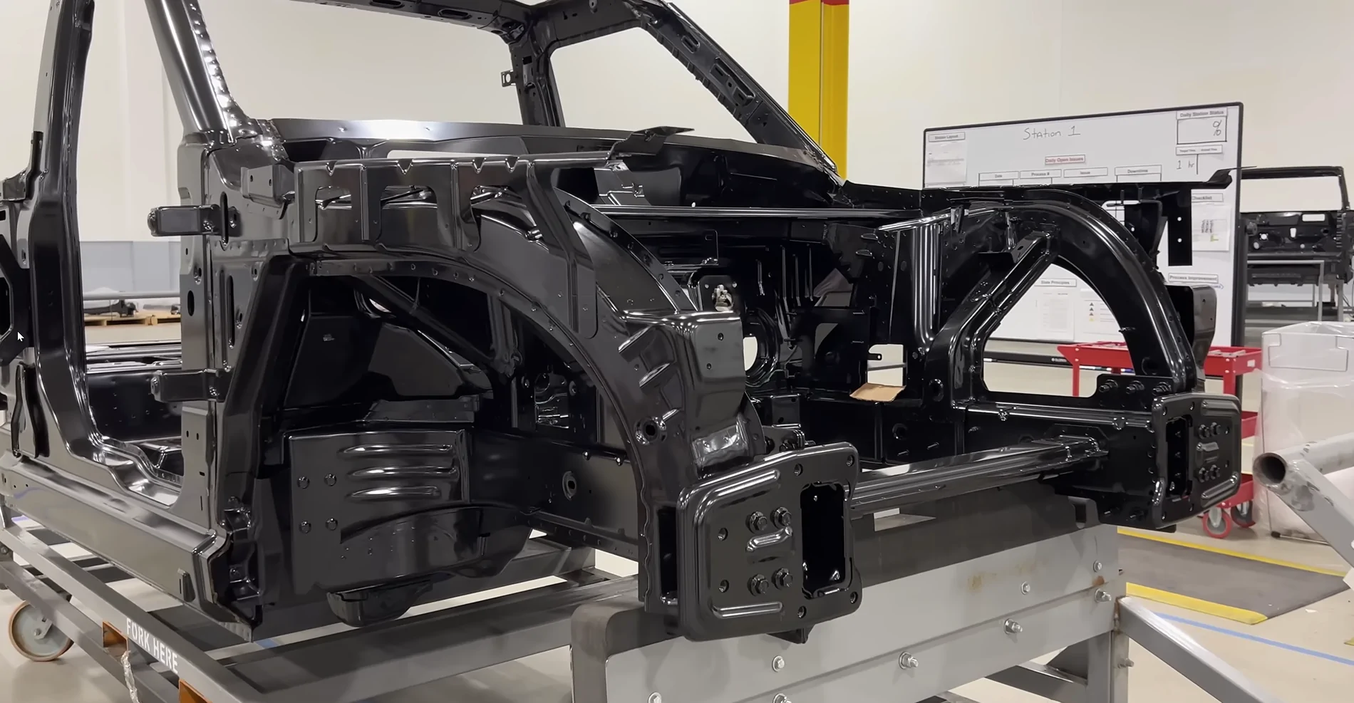

I could be wrong but the Slate front end doesn’t even look robust enough for tow hooks and the rear only strong enough for 2,000 pounds… implying incapable of pulling a 4,000 pound vehicle.
664
1,748
The plastic bumper shell isn't robust enough for tow hooks, but the frame members behind it look pretty beefy to me:
2026-08-29 15_21_41-(187) Inside Slate Auto’s EV Facility _ Tour with CEO & Lead Engineer - Y...webp
(screenshot from this video). I wouldn't bolt a tow hook to the composite, but I'd be willing to put a receiver or winch or tow hooks there. Be smart with your recovery plan (static loads with static straps and chains, dynamic loads only with dynamic straps and ropes) and those points will be plenty strong.
No one expects it to tow more in reverse than it does in forward - take a look at the picture at the top again, the truck is pushing the trailer backwards rather than being pulled forwards by it. Super, super nice configuration for the many times you find yourself playing "Gridlock" with the various trailers you have to deal with in a busy yard.
