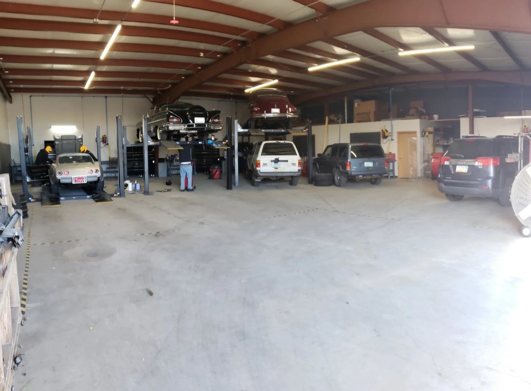

Right now I am stuck with boring projects on houses and buildings because they pay the bills.
But a couple years ago I had my garage all clean, organized, and full of toys. The 4 on the right were mine and the 2 cool ones on the left were friends.
I was replacing the trans seals on my Packard in the air, and the fuel injectors on the 4 Runner.
Sold that GMC Terrain as soon as I could, and drove that great little Cherokee till someone just had to give me enough to pry it out of my hands.
Always have a ton of projects.

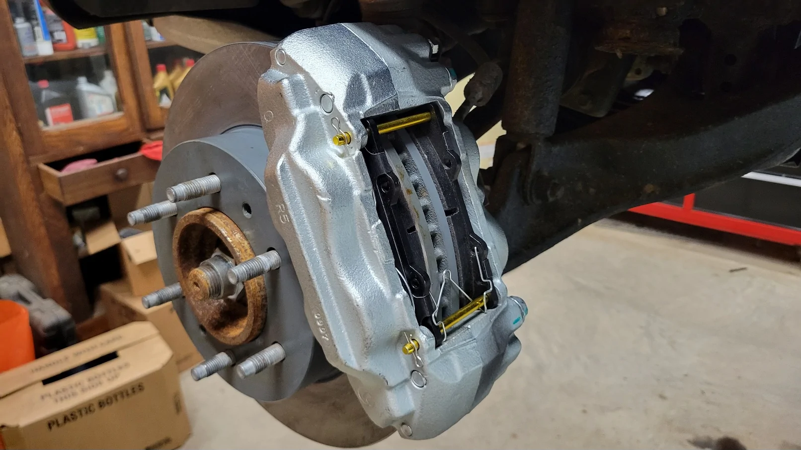

Nope, brake lines are all good. Front hoses are just a year old. Right caliper started to lock up a few weeks ago and ate through the inside pad. Pedal was firm and normal until I replaced the front brake hardware. I get a full firm pedal and it stays firm and stops well, just when I move 50 feet and reapply the brakes the pedal sinks all the way to the wall (still give brake action too). The pedal pumps up firm again and stays firm (even over night). No ABS light. I think it is the accumulator, but not sure. Has me frustratingly perplexed.
A friend is a professional mechanic; he will run the service bleed procedure for me. I've bled it 6 ways to Sunday: gravity, assistant, and at 25 PSI with my Motive pressure bleeder (wet). My POS GM scan tool is defunct so I can't run it. Considering I'm replacing the H3T with the Slate, I'm not investing in another GM scan tool.
Problem is it is hard to find parts for the brake system. GM no longer makes the master cylinder, ABS pump, nor accumulator. I've not found aftermarket parts on line either. PITA. LOL
Nice diggs.

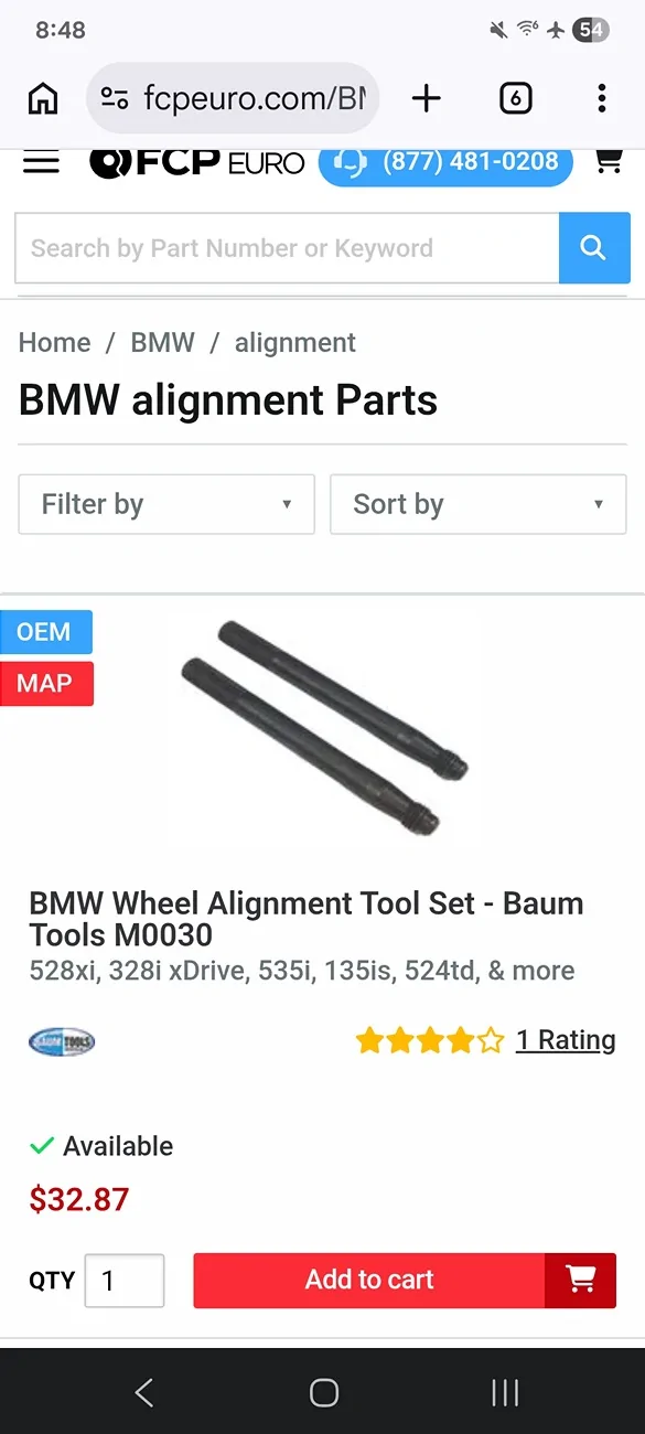

Easy, find out the thread specs (probably M12 or M14) and get a long bolt and cut the head off. Or FCP Euro should have a wheel bolt pin for VWs. You thread the pin into one of the wheel bolt holes to use the pin to slide the wheel onto the lip of the hub.

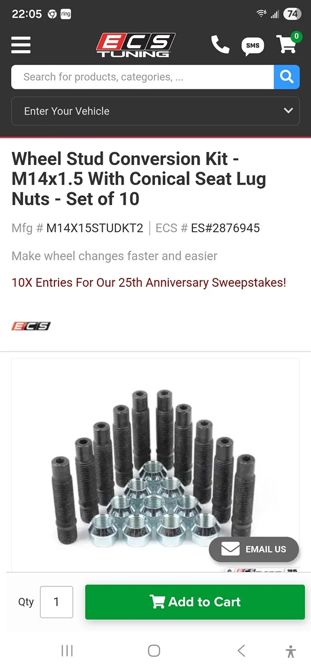

If it is too much of a pain there are kits to change it to the stud / lugnut design that are pretty simple and run $20 to $150
Amazon/ecs tuning and many others.
The OP just needs this:
Ebay has one single pin for $7.00. He just has to verify the thread size. The Germans use either M12 or M14 wheel bolts. A Tiguan probably uses M14.
