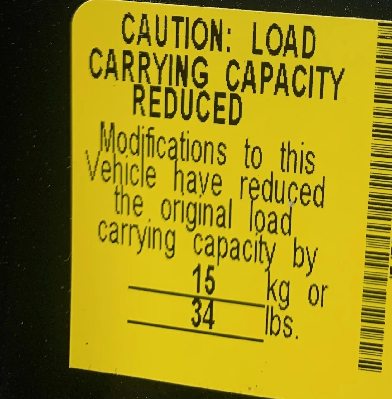

OP, I'm sure when order books open, the towing and payload capacities will be spelled out by battery configuration. This is standard practice in the industry. And you'll have tons of time. Most OEMs open the order books months before first delivery.
Your post just reminded me that one of my vehicles has this little yellow label on the door jamb.
NHTSA regulations require that: if an OEM or dealer adds accessories that reduce payload, the buyer must be notified.
So you should expect to see this sticker on your Slate with the extended range battery. I wonder if a similar sticker will be included with the SUV kits, for the owner to install.
