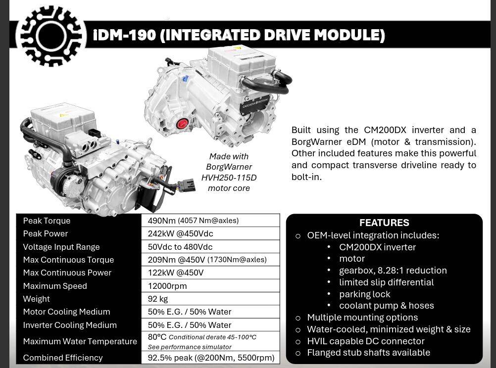

the data sheet for the drive motor that looks to be the one slate is using (https://www.slateforums.com/forum/t...gwarner-in-slate-prototype-video.13170/)calls for a 50-50 mix of water and Ethylene Glycol for both the motor and inverter (https://www.cascadiamotion.com/idm-190.html)... so it is your typical green very basic coolant, I would assume that the battery would use the same coolant if it is water cooled.
you are likely going to need a vacuum filler to purge the air out if you were to DIY it.
