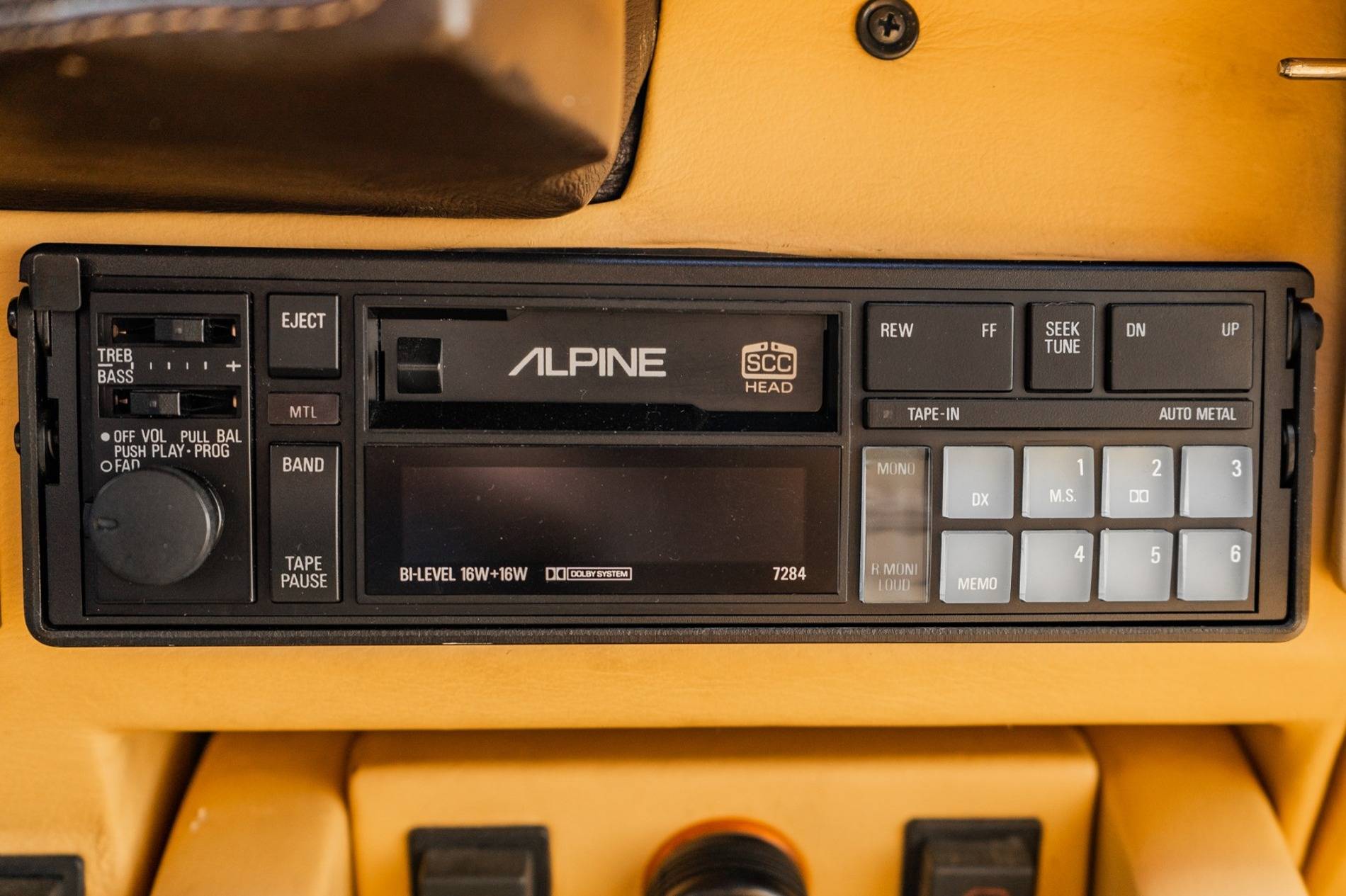

Having lived in a hot climate, I've experienced thermal throttling and shutdowns with almost any mobile device or tablet. Since Slate claims the BYOD isn't mandatory to operate the car, it shouldn't matter. If you absolutely need a nav screen though then a purpose built infotainment device is most likely the answer like those single din android devices.
