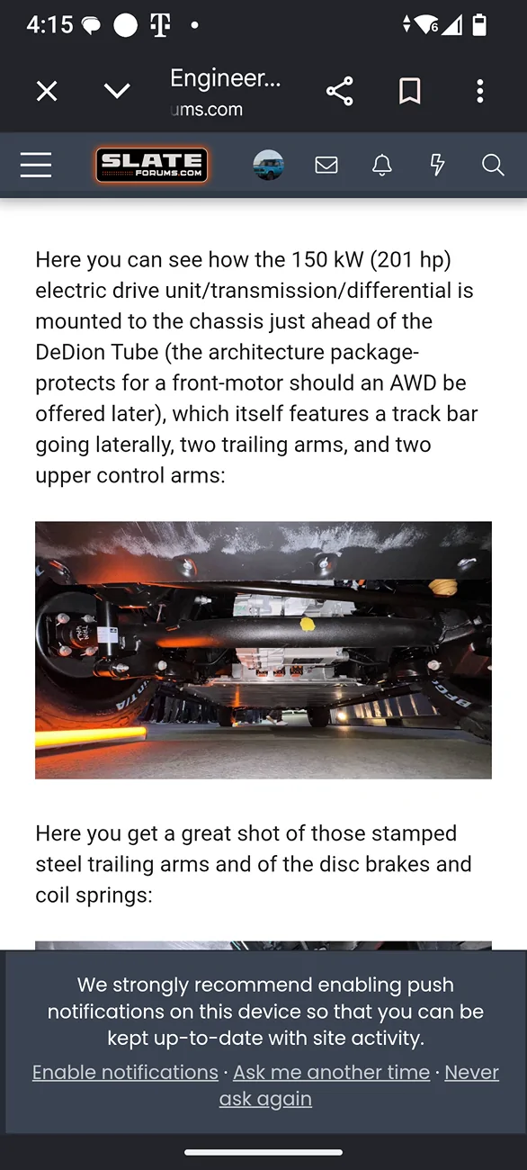

According to this article clip, it sounds like they might have already considered the possibility for the future, although this is dated last year (like you were saying @beatle):
Slate Auto Pickup Truck So, hear me out...(a way to kill 2 birds w/one stone?) Screenshot_20260624-161509
