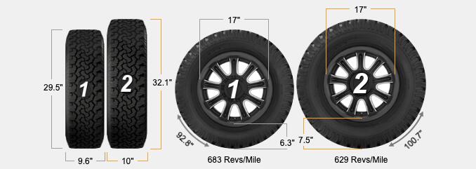

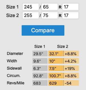

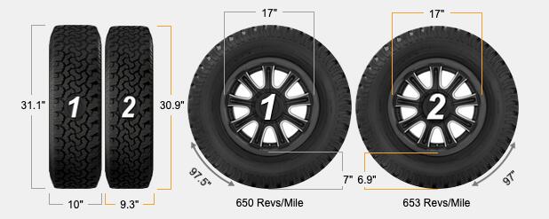

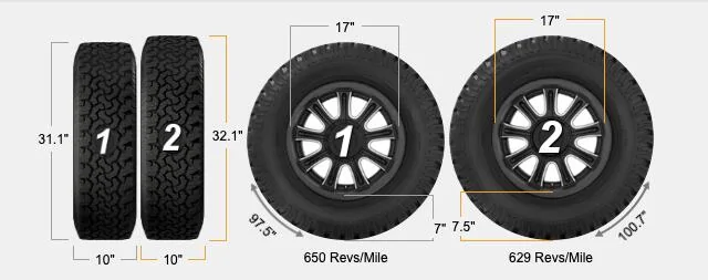

The configurator's "All-Terrain Tire" shows 255/70R17 (not 32").
255/70R17. (31.1x10) - Speedo Error @ 50mph: 52.7 (+5.4% circumference)
BFG All-Terrain T/A KO2: 49.3 lbs (E)
BFG All-Terrain T/A KO3: 50 lbs (E)
Falken Wildpeak A/T3W: 42.3 lbs (E)
Falken WildPeak A/T4W: 43 lbs (E)
Toyo Open Country A/T III: 38 lbs (Standard Load, 2469 lbs)
Toyo Open Country A/T III: 47 lbs (E)
Data and screenshot are from TireSize.com. I have no affiliation.
https://tiresize.com/comparison/
Slate Auto Pickup Truck Taller 17" All-Terrain Tires for OEM Wheels Compare_255-70-17
(cont'd...)

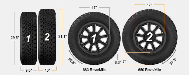

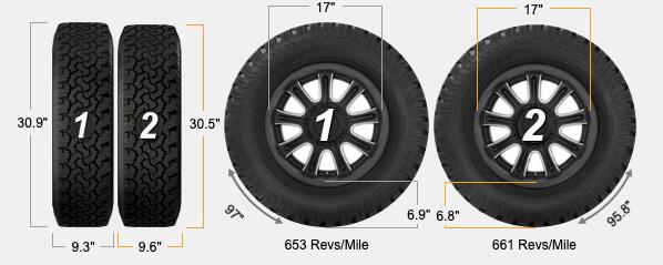

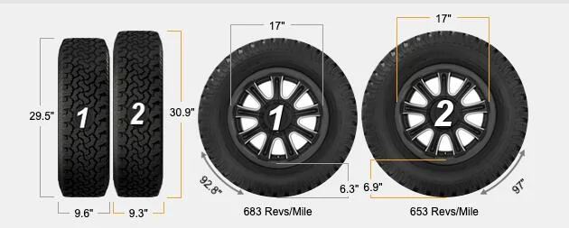

Here are some other alternatives:
Slightly taller and narrower than stock 245/65R17
235/75R17 (30.9 x 9.3) - Speedo Error @ 50mph: 52.4 (+4.7% circumference)
BFG KO: N/A
Falken Wildpeak A/T3W: 37.9 lbs, 31.1" (Standard Load)
Toyo Open Country A/T III: 36 lbs, 30.9" (Standard Load)

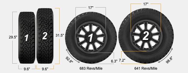

+1" size (stock 245/65R17 plus an inch in diameter)
245/75R17 (31.5x9.6) - Speedo Error: @ 50mph: 53.4 (+6.8% circumference)
BFGoodrich All-Terrain T/A KO2: 49.1 lbs, 31.5" (E)
BFGoodrich All-Terrain T/A KO3: 52.9 lbs, 31.5" (E)
Falken Wildpeak A/T3W: 41.4 lbs, 31.5" (Standard Load)
Falken WildPeak A/T4W: 49.8 lbs, 31.8" (E)
Toyo Open Country A/T III: 47 lbs, 31.5" (E)
Heaviest tire: 52.9 lbs
Lightest tire: 36 lbs
Multiply the difference times four and you have 67.6 extra pound to rotate. larger diameter notwithstanding. Larger diameter is also a "bigger flywheel" to turn and it effectively changes the gearing, similar to having a higher final-drive gear.
Out of these two sizes I think the 235/75's (30.9"x9.3") could be a good conservative choice for the Slate because of weight and diameter. If it doesn't require a lift, all the better.
Screenshot is 235/75R17.
Slate Auto Pickup Truck Taller 17" All-Terrain Tires for OEM Wheels Compare_235-75-17

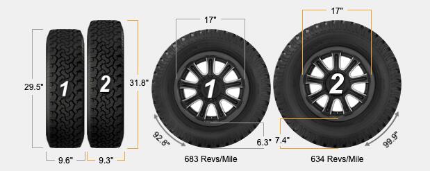

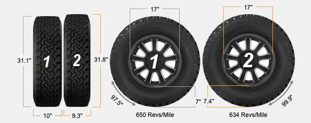

Here's another alternative.
Not quite 32", but close.
These Pizza Cutters would undoubtedly require the Lift Kit.
235/80R17 (31.8 x 9.3) - Speedo Error @ 50mph: 53.9 (+7.8% circumference)
BFGoodrich All-Terrain T/A KO2: 47.7 lbs (E)
BFGoodrich All-Terrain T/A KO3: 49.6 lbs (E)
Falken Wildpeak A/T3W: 48.5 lbs, 31.8" (E)
Falken WildPeak A/T4W: 47.1 lbs, 31.8" (E)
Toyo Open Country A/T III: 46 lbs, 31.8" (E)
Slate Auto Pickup Truck Taller 17" All-Terrain Tires for OEM Wheels Compare_235-80-17

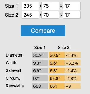

Will the speedo be mechanical? On our 62 3 on the column I removed and capped the speedo cable and we are using a speedhut gps speedo. No need for math or mechanical failure.
I expect the speedometer accuracy to be adjustable via the app.

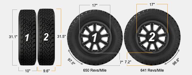

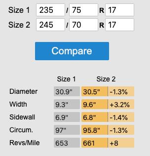

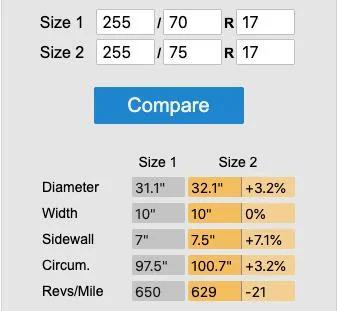

I put the speedo data in there as a proxy so you can know how different the alternative diameters are from stock, if that makes sense.
Double it to get the percentage. For the 235/75R17 tire it's roughly 4.8% off because the larger tire rotates 30 fewer times per mile.
FWIW, most speedometers come from the factory reading slightly high.
You can plug two sizes into the TireSize.com Comparison Page to see data galore.
Slate Auto Pickup Truck Taller 17" All-Terrain Tires for OEM Wheels 235-75-17_Data
EDIT: Circumference percentages added and typo fixed.
