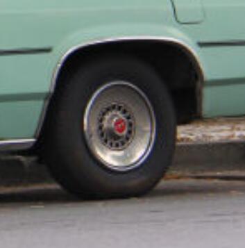

Almost every car I've owned or worked on has had 205/215 tires, and that's everything from My Thunderbird, Geo, LTDs, Buicks, old trucks, etc. Could definitely get away with a narrower tire gauge. Even the biggest hauler of them all, a Dodge D250 cummins ran 215s for the 6600GVWR rated truck.
Edit: Early 80s LTD/ LTD Crown Vics came with14 inch wheels, now THOSE tires never feared potholes
