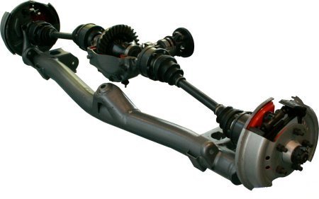

I do believe that DeDion is easily one of the most underrated suspension types, and think it was a great call to use it here.

Is the De Dion tube (crossmember) an axle? If so there are three axles because the half-shafts are axles.
65
106
One word can have multiple meanings, and multiple words can have the same meaning. That's how you can have axles inside the axle on one axle, and axles with no axle on the other axle. Isn't English* grand?
* And that's even before getting into the different Englishes.
213
264

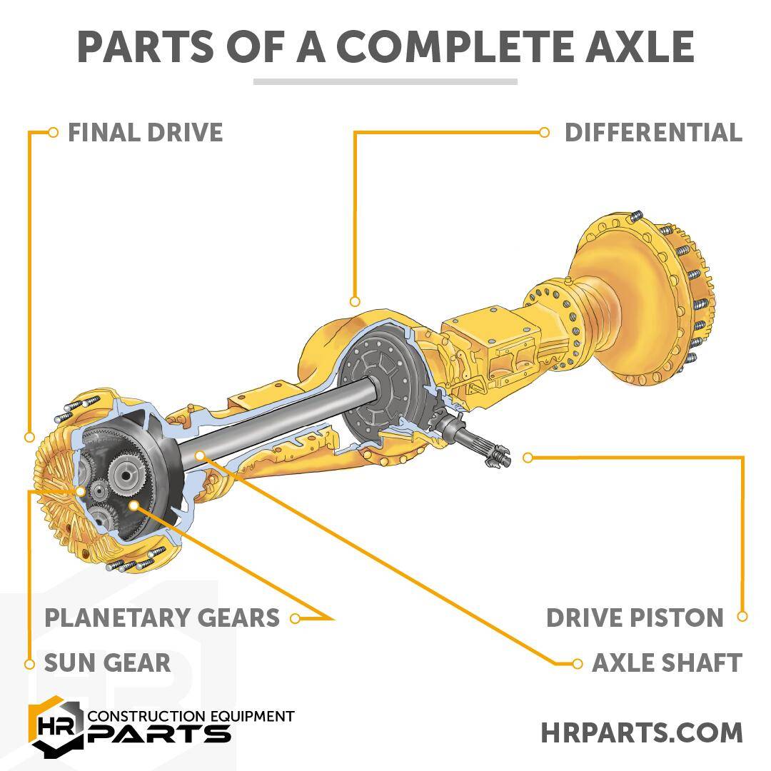

On a normal axle the axle shafts are inside the axle housing(tube), on the DeDion the axle shafts are outside the tube.
The main difference is the differential is on the body of the truck (DeDion) vs in the center of the axle tube.

I queried AI. Here's the summary of the answer:
In summary, while the de Dion tube functions similarly to a beam axle in terms of maintaining wheel alignment and suspension geometry, it is not typically called an axle in the conventional sense due to its lack of involvement in power transmission. Instead, it is more accurately described as a suspension beam or de Dion tube.​
213
264
The AI isn't wrong, the Dion tube is not an axle just like the axle housing isn't an axle on your traditional setup.
In both situations we are talking about the full assembly.
