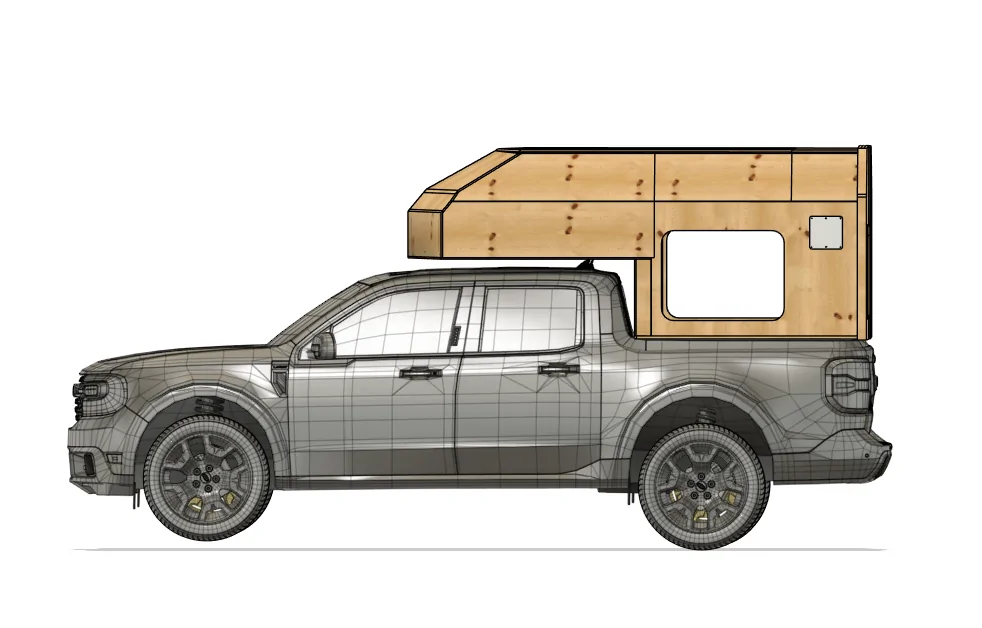

I'm interested in a camper shell for the Slate.
While I'm impressed with your design and ingenuity, this design seems too complex & heavy. I see problems with the sliding part such as water leaks and wear. Overall it goes against the Slate ethos of reliable simplicity. But that's just me.
What other materials have you considered for the panels? Some travel trailer manufacturers will use polystyrene foam boards laminated with aluminum and/or vinyl.
I have a nose over design as well that would work for the Slate, and the slide is optional. I was just trying to brainstorm some ways to make the 5ft bed work, while staying lightweight and aerodynamic. Attached a pic of nose over on a ford maverick.
Slate Auto Pickup Truck Feedback on a prototype camper for the Slate maverick nose over

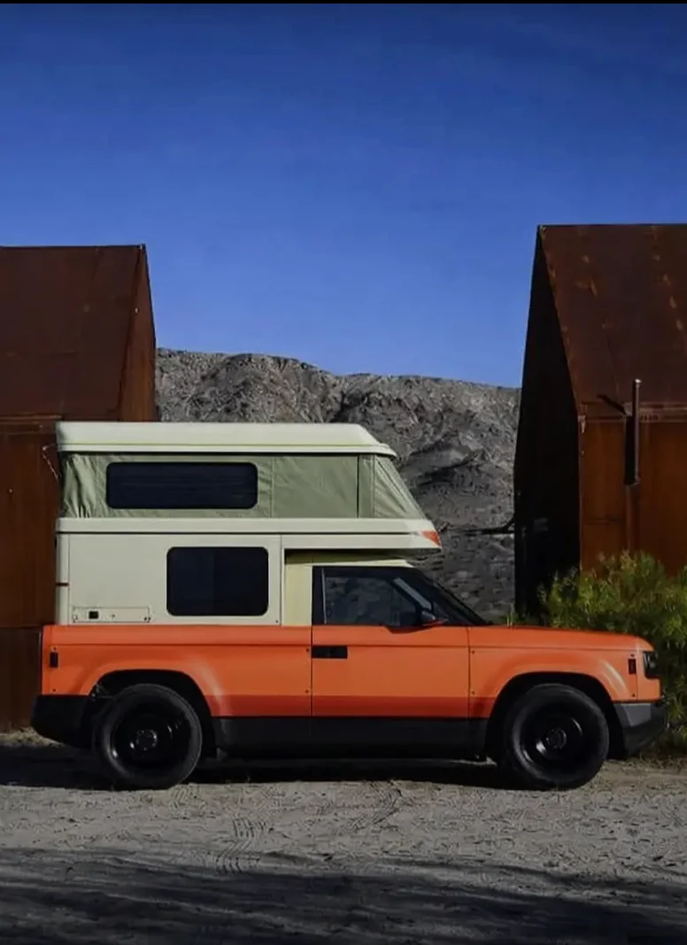

Well it looks like the camper concept is taking off. Here is a rendition I spotted on the web.
Here's my 2 cents on this camper concept. There are lots of pop up roof options on the market and strong demand for being able to stand in the camper when arriving at camp. Aerodynamics are super important on the Slate so the low profile of a pop up roof is very appealing. I already saw where GFC is working on a version for the Slate which fits the bill. If what is pictured above is made of fiberglass, composites, or aluminum, I think the cost is going to get very close to the cost of a Slate (if not more). The niche I'm going after is the full hard sided while sleeping. While this probably won't allow standing up inside the camper, my design moves stand up tasks under the hatch door of the slide out in a fabric annex room space. See my website for a rendition of the annex room option.
