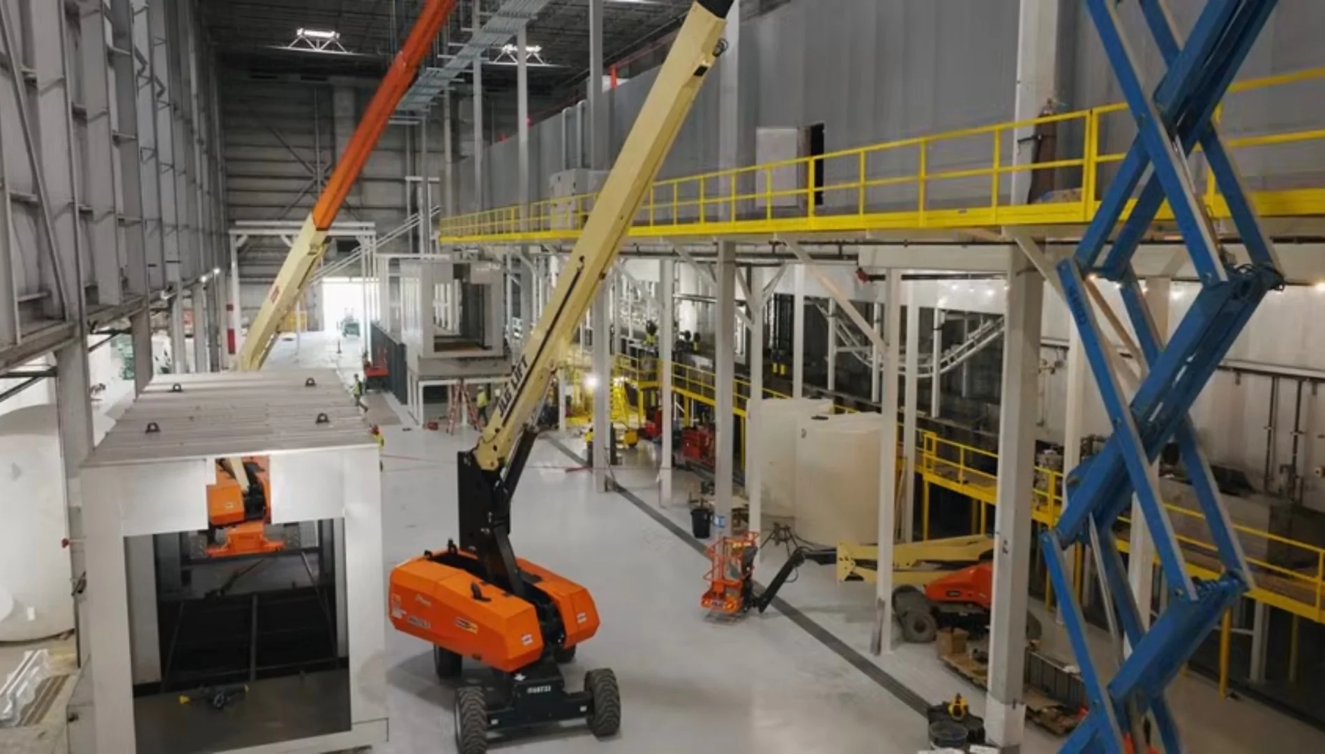

You rang?…. I haven’t listened to the recent board interview podcast yet but in the synopsis the OP posted it was mentioned that they talked about Slate’s e-coat line being 70% complete.
In the “New Day in Warsaw” video they give us 2 or 3 shots of their under construction e-coat line. Please note I’m not in automotive e-coat, but the process is the same.
The right side here shows tanks (a weir box is visible behind the blue scissor lift) and several chemical storage tanks are visible around and under the line. The chassis are conveyed in the upper portion and they dip down into the tabks

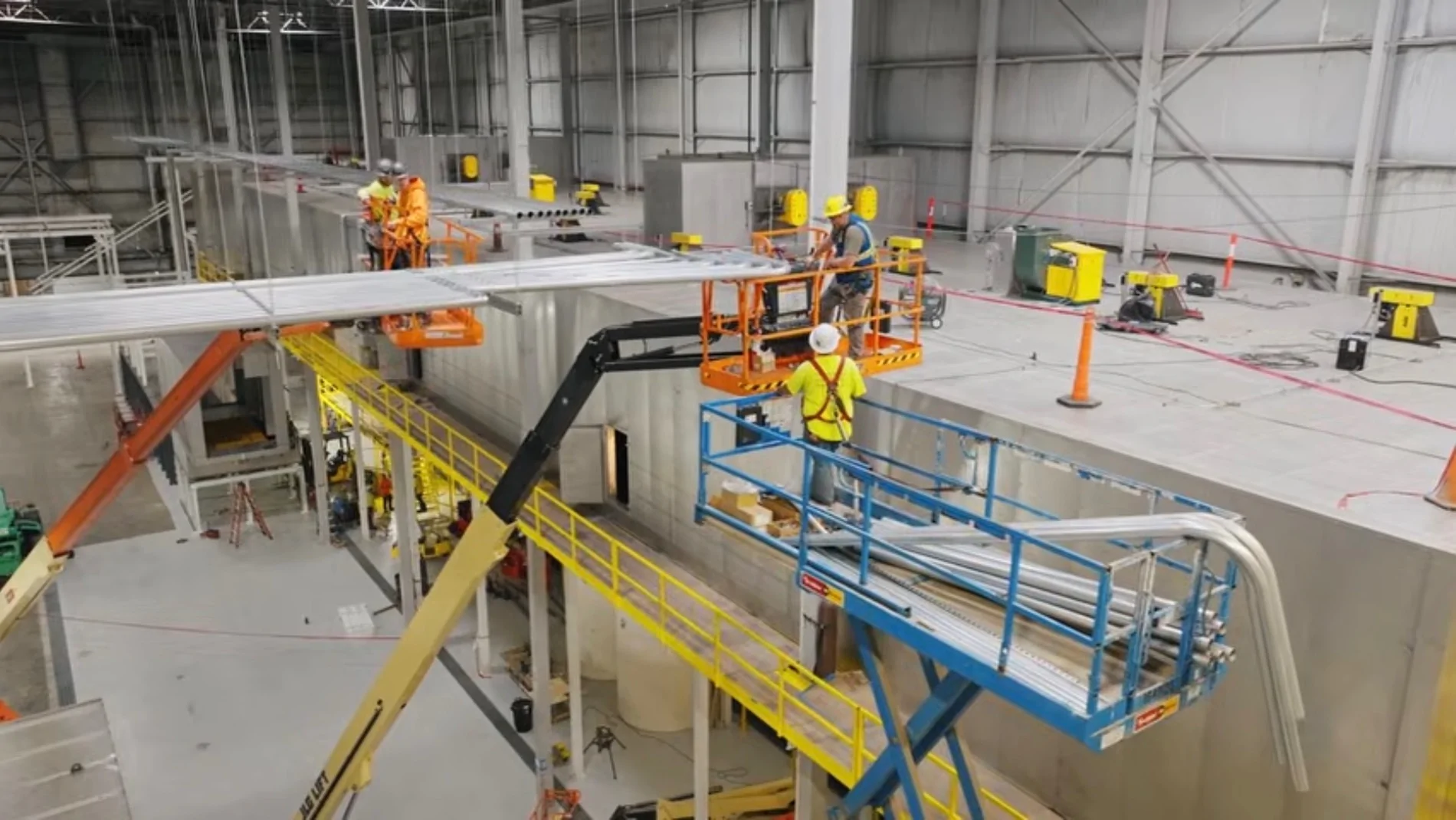

This photo is the same right side as the first, just from above. I see exhaust fans and turbulators (air mixers), maybe some burner boxes too, most likely to help dry the chassis between stages of pretreatment (but that’s a big guess)

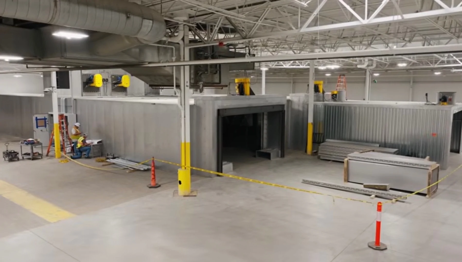

And finally, these appear to be ovens or furnaces. They could be their e-coat bake ovens, but usually those are on the upper layer of the conveyor line. These are 1 story tall and on the ground. They are probably for strain relief on the chassis after welding or some other purpose. They certainly get hot inside.
