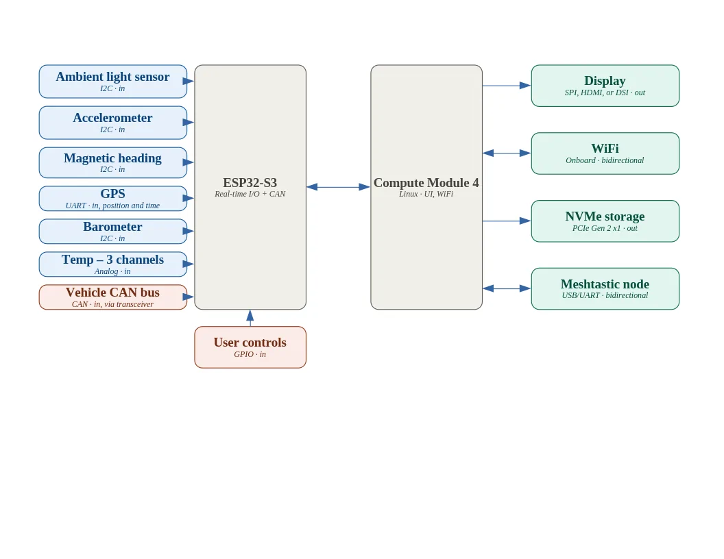

Hi,
Years ago I built a automotive display (generously) prototype that had accelerometers, a magnetometer (heading), a GPS (for timing and location), temp inputs, and even a barometer. It was way too crap-tastic for real use but it taught me a lot! I'm thinking that I have about 95% of the skills to make something proper for my Slate. I can do the board schematics/lay-outs, most of the code, but I have the fit and finish and UI skills of a caveman. Is anyone interested in a collaborative opensource project? Looking at the parts needed, etc, it looks like this could be DIY done (with proper PCBs) for just a few hundred dollars. I'm not talking about some icky big display, but some slim/wide form factor. I've attached the block diagram of what I am working on. Do any of you have interest in this project?

I think the idea is great, it would be fun to have a modular interface to show more detail without having to jump through the hoops of an ODBII bluetooth ELM interface to an app like Carscanner.
Main thought is - do you even need the Pi compute module? You can do a LOT with the ESP32-S3, you have wifi and BT onboard already, and you can run a wide variety of display modules. I'm not sure if you'd run into a memory limitation handling the CAN data and the display detail, but there is certainly enough IO to handle the sensors you are thinking about.
I go back and forth on that. i put the cm4/5 in the architecture mostly for extensibility. I do think a version 1 could be viable without the pi.
i just wan to plan for the future!
