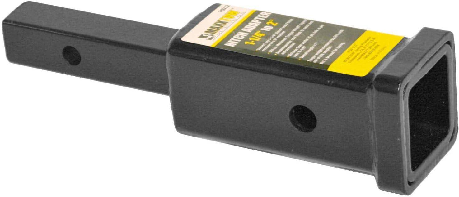

Agreed. I don't think the basic Slate will be able to tow over 1,000 lbs, so a smaller 1 1/4" hitch may be what they're thinking, however I've found that some of the hitch-mounted accessories like hitch carriers for mobility scooters, etc, REQUIRE a 2" hitch. Don't need to tow 3,000+ lbs, but need the 2" for adding the accessory.
I know you can purchase 1 1/4" to 2" adapters but that will lengthen the moment of leverage of the load far out, possibly beyond the limits of the Slate.

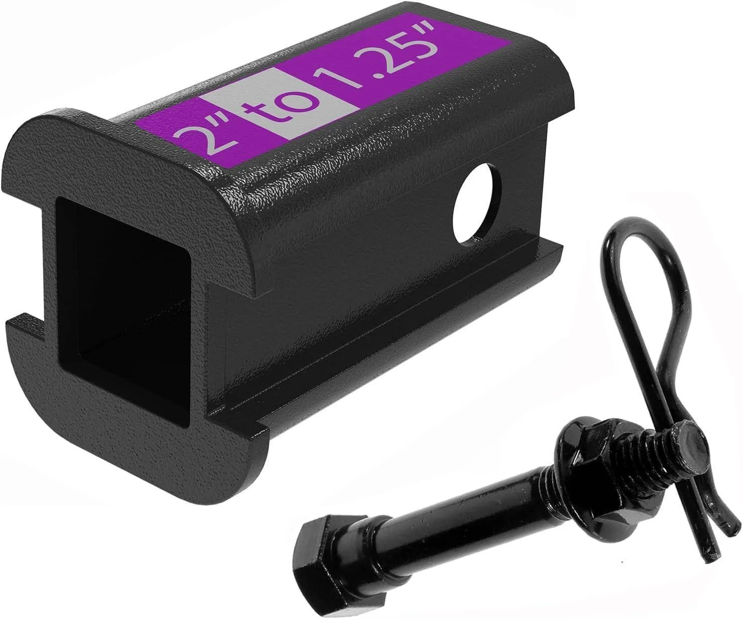

Better to start with a 2" hitch and get a 2" to 1 1/4" adapter keeping the hitch length a little shorter.
