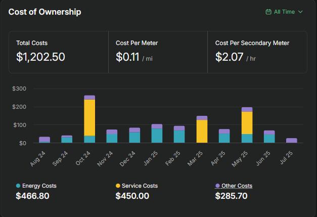

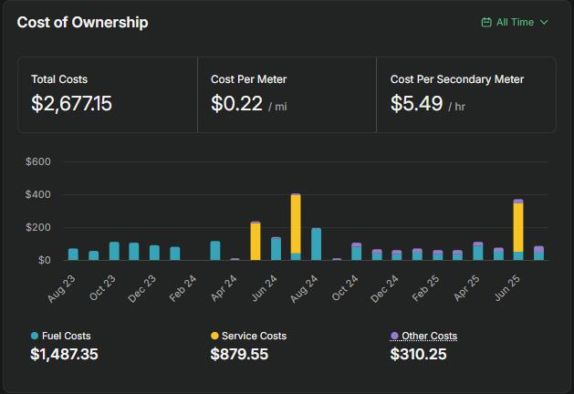

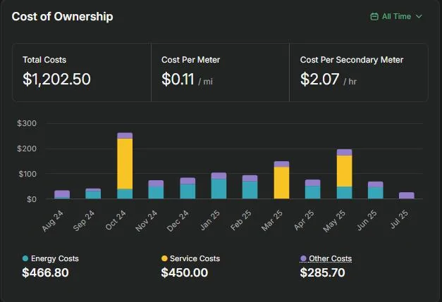

I manage a fleet for a city near Dallas. We've just started down our EV path, so I don't have much data yet, but I can offer an initial comparison.
It's not a perfect one-to-one comparison, but my fleet includes a 2023 F-150 Lightning EV and a 2023 F-150 ICE (2.7L EcoBoost). We have about a year of data for the EV and nearly two years for the ICE truck. Both have been affordable to maintain. The only issue with the Lightning has been some tire damage that required replacement; otherwise, it has needed almost no maintenance.
Even though the ICE truck has been in service longer, both vehicles have similar usage statistics: around 12,000 miles and 500 hours. The Lightning is significantly cheaper to operate per hour, resulting in a total cost of operation that is roughly half that of the ICE F-150. This gives you an idea of how much lower the maintenance on an EV can be, at least for the first year. We'll see how it holds up as the vehicle ages.
What surprises me the most is the stark difference in the hourly operating cost. Many vehicles in my fleet idle for a significant part of the day, which drastically hurts the fuel mileage of our gas-powered trucks.
F150 ICE Cost of Ownership - Pm service is the service costs. Other costs is GPS trackers, state registration, etc.

F150 Lightning EV Cost of Ownership - Pm service is the service costs, and 2x damaged tires

That's some great data. I have spreadsheets going for all of my vehicles, and am looking forward to doing a similar analysis in the coming months as our ID4 becomes our primary vehicle.
